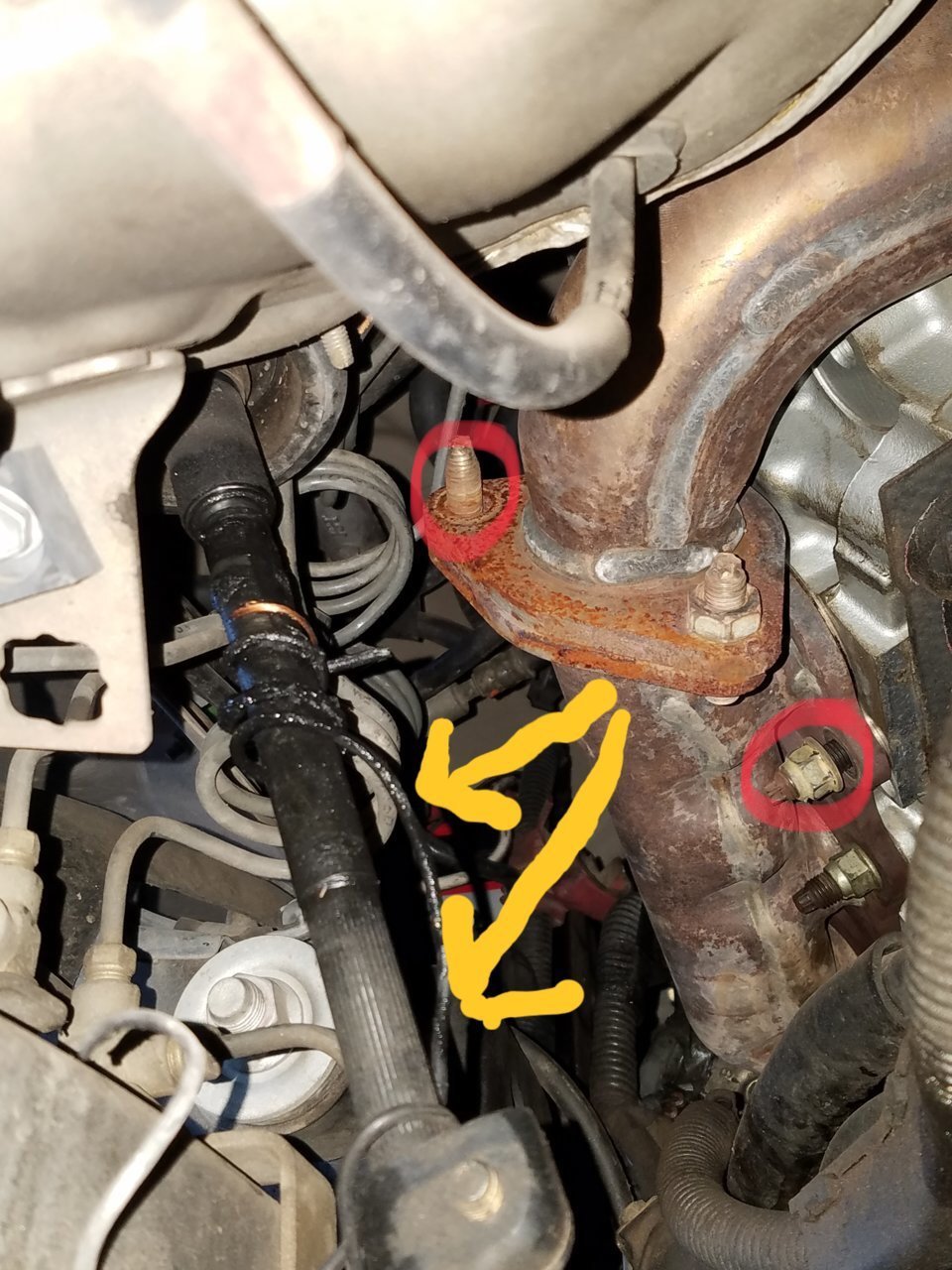

What is this wire that someone cut??

    There has to be a 12v source somewhere at the rear end harness, maybe to the fuel system.

    Believe me, you don't want to power your camper lights from wires "essential to guts" of your truck. This is like connecting a coffee maker to USB port in your PC.

    I’d tighten your header down while your Under there

    I didnt even notice this. I just had an engine replacement a few months ago, it must have been the mechanics who failed to do this. Thank you

    Where can I even find a new nut to replace this? Should i contact the dealership? Home depot?

    Oh boy, a shop left it like that? Hope everything else is actually done properly with the engine swap.

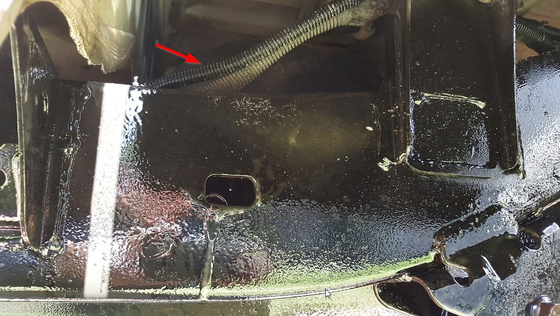

    My camper has two wires going in (besides ground). The third brake light is LED taking very little power and it is tapped straight to left brake lamp. I have all bulbs replaced with LED (including the third brake light in the cab, that nobody can see anyway :)) so I'm not worried about adding one lamp to brake circuit.
    The camper light is powered via separate wire put in a wire loom along the original rear lights wire loom, going into the cabin (under driver seat) and then through firewall all the way to the battery. That wire is protected by 10A inline fuse (close to the battery). My camper lights take about 6A total (two double row LED strips and 5W LED bulb.)
    Inside that additional loom together with camper light wire I have also backup camera wire and rear fog light wire. You can see that loom on my fluid film picture (additional loom pointed by arrow)
