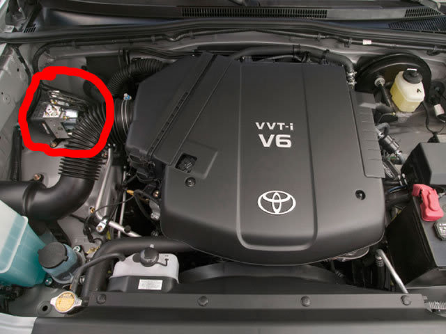

    So i was taking off a piece of my intake and i noticed this empty spot in the engine bay. Then, i looked up a tacoma engine bay online and discovered that there was a piece that occupied my vacant spot. Just curious if my tacoma is missing something else because it already had a misbuild with the radio. after all it was assembled in mexico.
    141_0611_08_z2006_toyota_tacomaengine_ba_1c0ffc704a9e313ebec2a5642a860cdc96bd39c9.jpg
    So i'm just curious what that piece does.

    That, if I'm not mistaken, is the anti-lock brake system controller.

    yup ABS module.

    looks like the lines go to the master cyclinder,so something for the brakes

    so i dont have the abs system in my truck? did they move it to a different area in the 2011's?

    On the TRD Off Road with A-Trac, it's replaced by a complicated servovalve/manifold thing by the brake fluid reservoir.

    ah, i can rest easy now. thanks

    You have ABS, but with ATRAC, the module is in a different location.

    x2 . . . . or atleast that's where mine is.

    Look on the other side of your engine compartment by the brake master cylinder. I suppose it differs by year and by whether your truck has vacuum assist or hydraulic assist.
    You have ABS, TRAC, VSC, etc.; that's all been standard on 100% of all tacomas since 2009. The factory can not have forgotten to install the brake ABS/VSC/etc. controller, because there is not a parts configuration for building a tacoma without the ABS braking system.

    My 07 TRD Offroad has ABS, VSC, TRAC, HAC, DAC, but not ATRAC. The anti-lock brake module is under the master cylinder on the drivers side against the firewall. The area the op is questioning was left blank on my truck with a bracket and three threaded studs.
