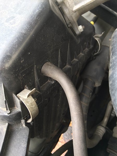

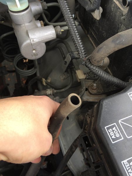

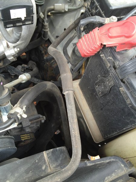

    Sorry if this is a stupid question, but I followed this line from the air filter on and it ended with it not connected on the other end (see pictures). Is this other end supposed to be plugged into something?

    Something is not right. I think that goes to the charcoal canister. The built up fumes in the canister get sucked into the intake to be burnt when you start the truck next.
    Do you have a check engine light lit? I'm betting you do and the code has to do with the evaporative system.

    Evap system like what ^^he said. It will throw a code if its not plugged in.

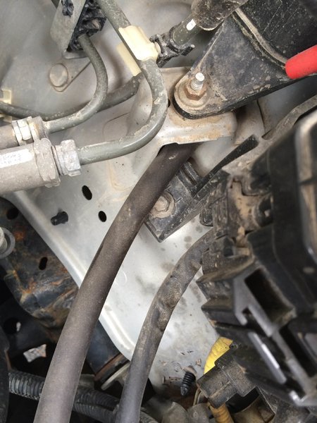

    Too ov 3rd pic I see a plastic hole of some sort, it looks to be the charcoal canister. That would be my guess.

    Sorry, 4th pic.

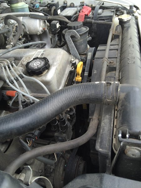

    same here 2nd top middle and 5th pic top right looks to be a nipple connection to evap cansiter

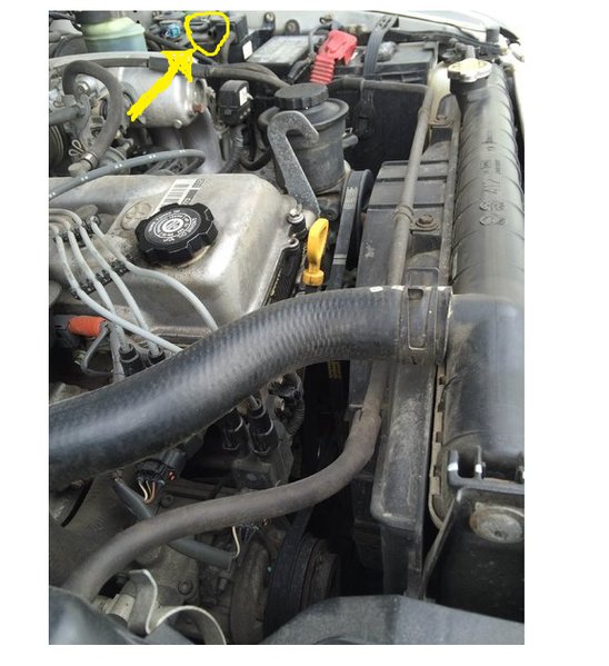

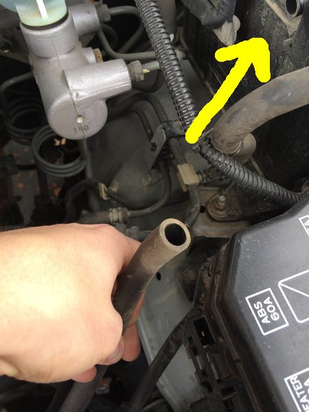

    I spy with my little eye where that line connects.

  11. Feb 15, 2016 at 2:18 PM
    Erkon
    Erkon Well-Known Member
    Nov 28, 2015
    #170839
    199
    Wisconsin
    2012 Pyrite Mica Tacoma TRD Supercharged
    Ignore the big yellow arrow. This pic is from a different thread started today, but you can see where that line goes!

    Your picture....

    I'm really surprised your check engine light isn't on. You wont notice much or anything with it connected. It is an emission related item.

    @Erkon I was gonna do the same thing with this pic :). all that tube does is provide filtered air into the charcoal canister since it's un-metered. it wouldn't do anything but let potentially dirty air in there and the intake through the air box. no biggie really.

    you could even put a small filter on the cannister and plug up the other end of that hose on the air filter housing.
