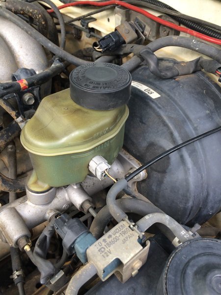

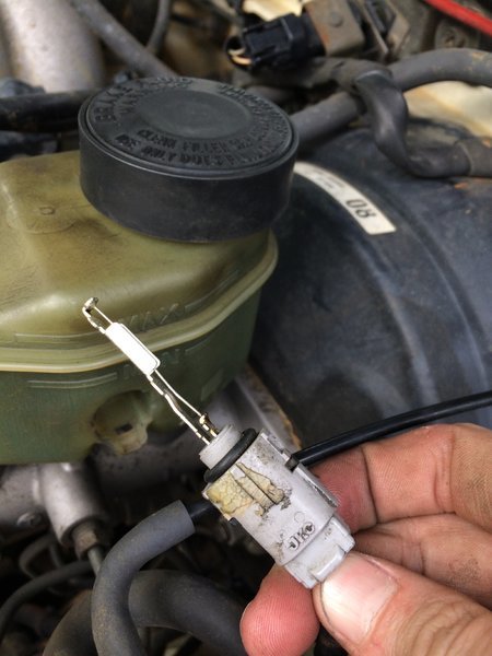

    So I have looked all over the internet for this and I can't find anything. All it says on it is, "JKC", 11207, and 5612. My E-Brake light is constantly on now and was told it was because of this. Anyone know?

    I believe that is the sensor that tells you when your brake fluid is low .
    Have you tried lifting the e brake pedal with your hands to see if the light goes off ?

    @gearcruncher I have the E-Brake that's to the right of the wheel that you pull back to engage but I can't find the sensor or anything online

    All the "handle" ebrakes I've had in Tacomas or in friends' trucks have had a tendency to trigger the brake light when not engaged. I'm pretty sure it's just a sensor by the handle itself, and the handle rotates clockwise a touch and falls off the pressure switch.
    Try pulling the handle out just a hair, rotating it counter clockwise (so it's dead horizontal or even a bit past with the right side of the handle a little higher), push it back in and see if the indicator light goes back off. This has worked in all my Tacomas, but the 97 I had it would only work for a second and then the handle would "slide" back down (rotate so the right side of the handle is a little lower), click, and the light would be right back on. I knew the brake isn't actually engaged so never worried about it
    Edit: After a little googling it looks like that sensor also causes the dash brake light if your fluid is low? Check this discussion of the different Toyota sensor types and this tacomaworld thread:
    https://forum.ih8mud.com/threads/brake-reservoir-sensor-switch-wiring.366966/
    https://www.tacomaworld.com/threads/emergency-brake-light-wont-go-out.20983/
    so maybe your light is a bad switch, but first I would try the handle thing, and then also just try increasing your fluid level a bit above the "full" line

    @nmiller08 I'll have to try the handle thing but I have filled the brake fluid barely passed and it stays on even if I reset it

    Well I went out there to try what you said and I guess from messing around with the one under my hood it turned itself off haha
