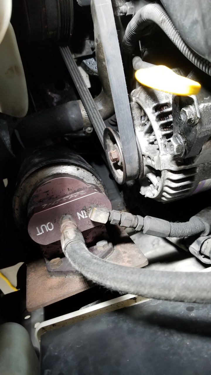

    What is this?
    Thanks.

    Oil catch can I think.

    Looks like an oil filter relocation kit.

    Secondary oil filter or a relocation / re-plumbing of the oil filter altogether. Think @wmg has something very similar

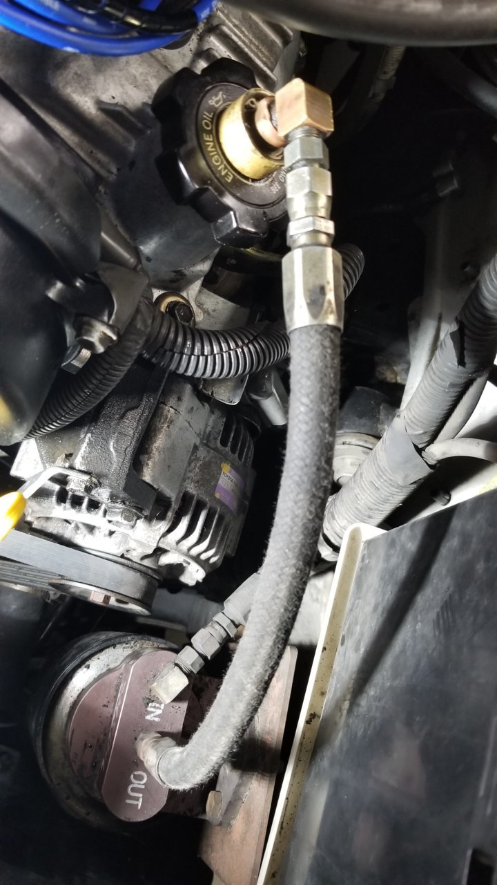

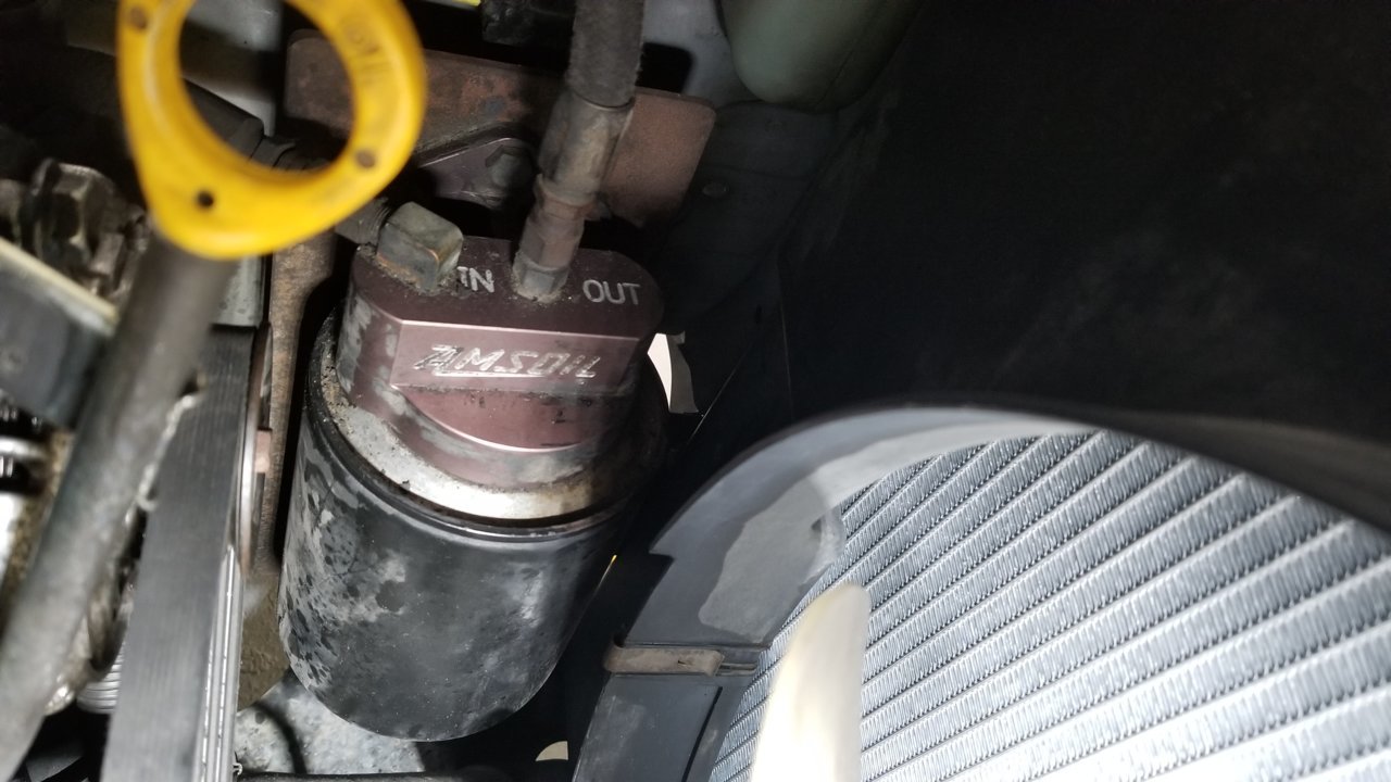

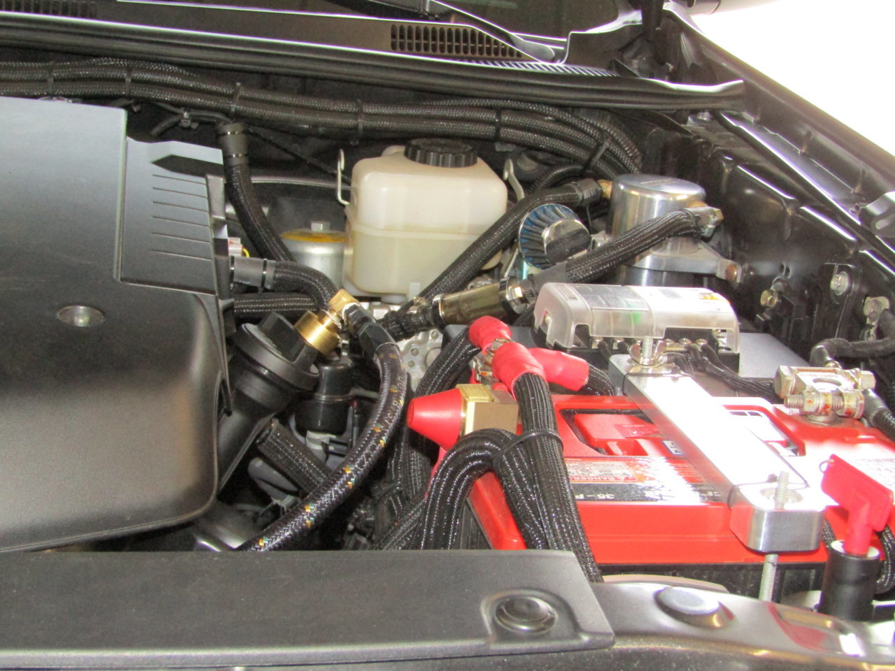

    6.jpg IMG_0272.jpg QUOTE="Wulf, post: 22437148, member: 147523"]It's an Amsoil bypass/remote oil filter setup.
    https://web.archive.org/web/2012050...m/bypassfilters/2003_toyota_tacoma/index.aspx
    On most vehicles a bypass filter supplements the factory oil filter and is capable of filtering out even finer contaminants for extended oil change intervals. Lots of diesel guys run them. I would be curious to see if this is a bypass setup with the factory filter still in place or just a relocation.
    https://www.amsoil.com/bypass/how-it-works.aspx[/QUOTE]
    my guess is its a early Amsoil unit, and the original filter is still in place, enclosed are a couple of pictures of mine , the OEM filter is still in operation..you can just see the top of the filter...
