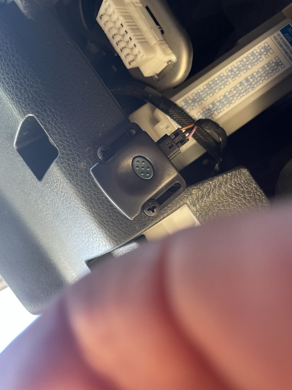

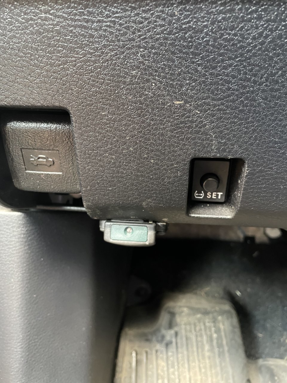

    Bought my 2017 TRD PRO used, I believe the little light box is after market. Does anyone know what it is ? Initial thought is something to do with alarm but can’t find on any schematic that shows it.

    Which one are you referring to? If you're referring to the one that says "set" is the tire pressure reset button. If you're referring to the green thing, it's aftermarket. Follow it behind to figure out what it is.

    That's a dealer installed immobilizer. It's to keep it safe on the lot, you could possibly ask them to remove it, but probably not likely

    It's a Karr Alarm

    Thanks I will follow and see where it leads. Purchased and shipped out California, second owner. Definitely not having to do with subwoofer. Stereo is weak. Love the truck.

    Not able to see where it leads immediately, will dive into. It has a button underneath and begins to blink rapidly when i shut the vehicle off and exit.

    It’s a Karr alarm as others have stated. It’s spliced into the starter signal wire and into a number of other wires for the door switches and other random stuff. I absolutely hate these aftermarket alarms as they can immobilize your truck if they malfunction.
