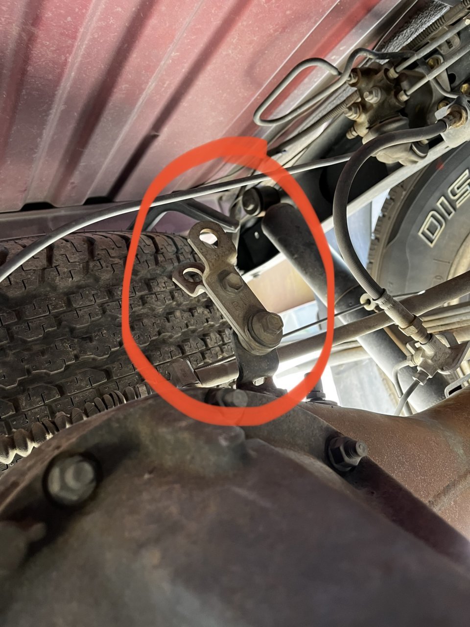

    2001 PreRunner Double Cab, Red
    I'm sure someone here can tell me what this fork-looking thing is attached to the differential case of my 2001 PreRunner Double Cab. Hopefully it's not real important because it doesn't seem to be doing anything and I couldn't find it on the diagrams on parts.toyota.com.
    Thanks!
  2. Jan 22, 2023 at 8:59 PM
    Aircates
    Aircates Well-Known Member
    Aug 26, 2022
    #404423
    197
    Texas
    1997 Tacoma lowboy
    Looks like a bent bracket for the parking brake cable equalizer.
  3. Jan 22, 2023 at 9:03 PM
    02hilux
    02hilux What do you mean there’s no road, I’m here
    Sep 14, 2016
    #197244
    6,338
    Planet: EARTH
    Yep. Someone bend the crap out of it too
  4. Jan 22, 2023 at 9:04 PM
    AZ01DC
    AZ01DC [OP] Active Member
    Jan 15, 2017
    #207632
    28
    Now that I know what to look for, that does indeed seem to be what it is. Thanks. I'll get under the truck tomorrow and see what's what.

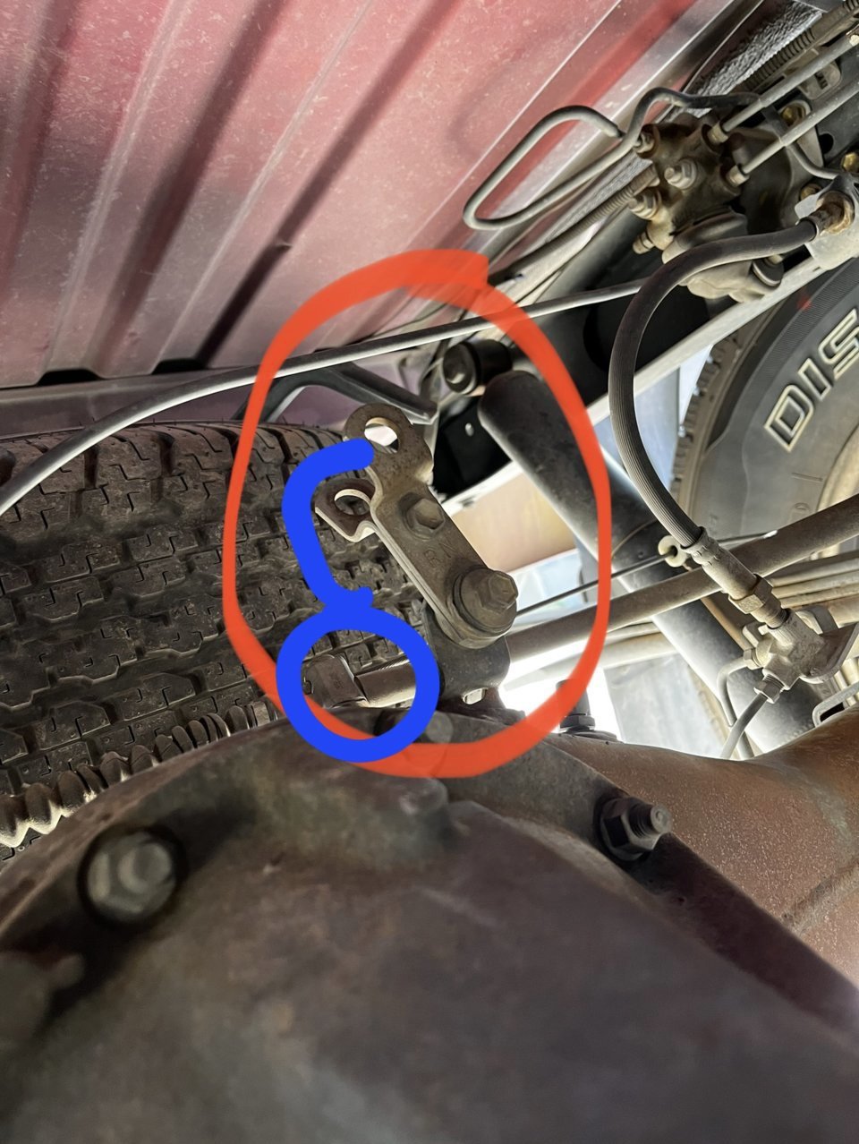

  5. Jan 22, 2023 at 9:06 PM
    02hilux
    Sep 14, 2016
    #197244
    6,338
    Planet: EARTH
    Circled in blue go between the 2 bracket. Must be bend back down too, towards the cable
  6. Jan 22, 2023 at 9:08 PM
    AZ01DC
    Jan 15, 2017
    #207632
    28
    Wow. Wonder how that happened? And thanks very much for the annotations to the photo, makes everything clear now.
