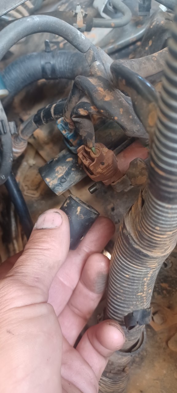

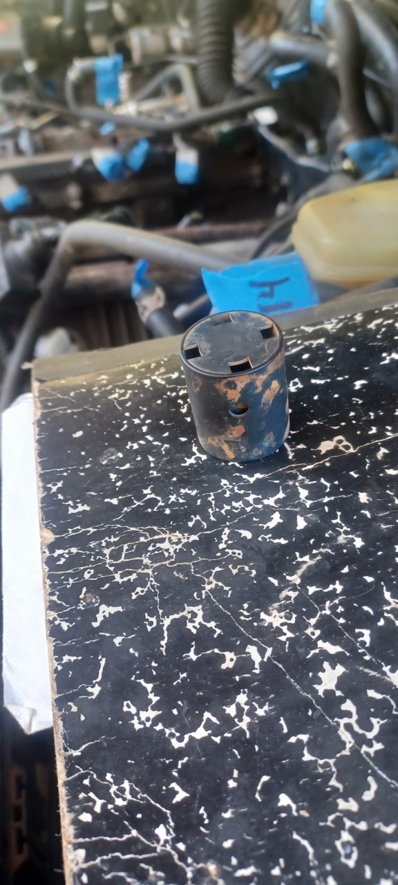

    While working the exhaust crossover pipe (i believe its called) this little plastic cylinder fell onto the driveway. I assume its a hose end of some sort, yet cant find the hose for it. I have marked all the hose and elec connections wit tape and numbers. Anyone have any idea what this is?

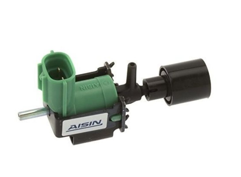

    Looks like a filter cap for a vacuum switching valve
    Something like this

    BRO!! you nailed it, i was looking for a stray hose, but it is indeed an "vacuum switching valve"
    Appreciate you, and the whole of tacoma world

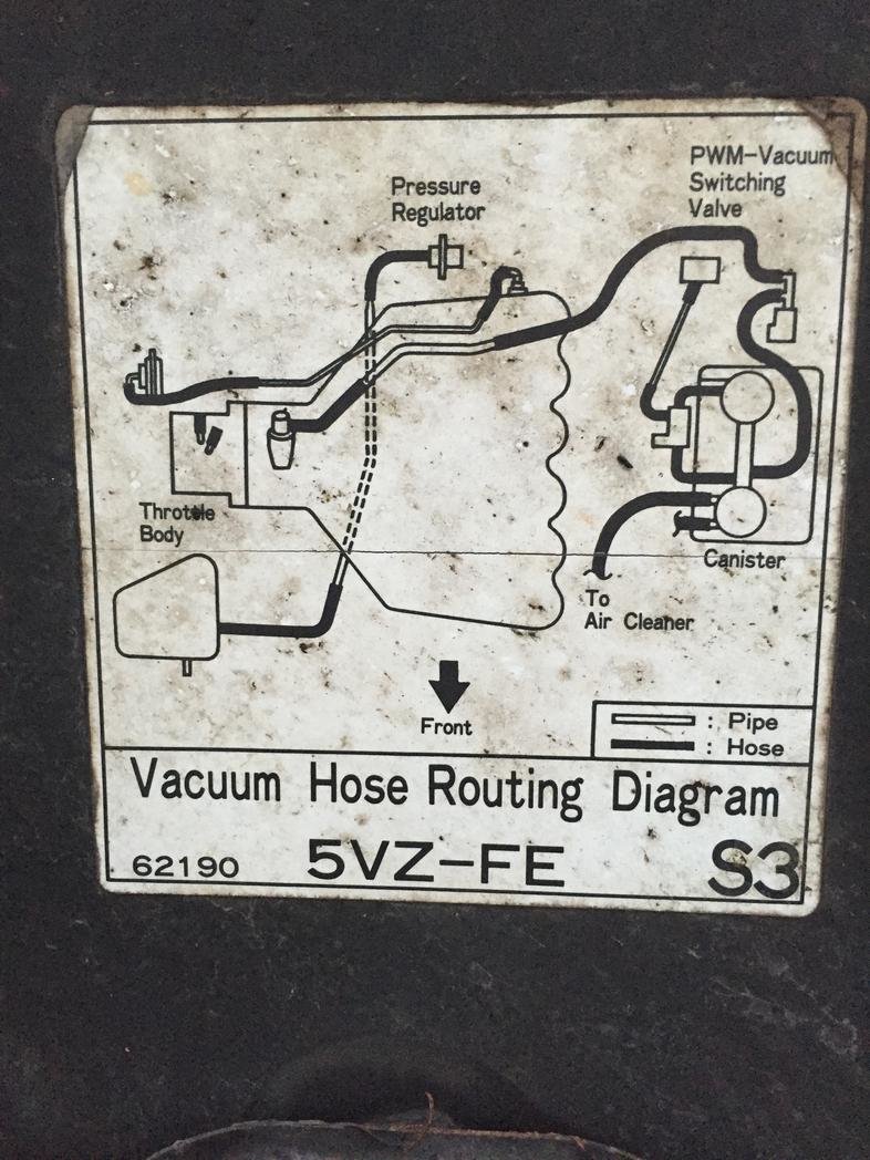

    Don't forget you can look at the vacuum hose diagram on the hood sticker
