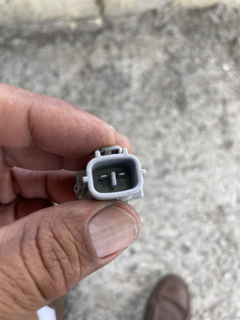

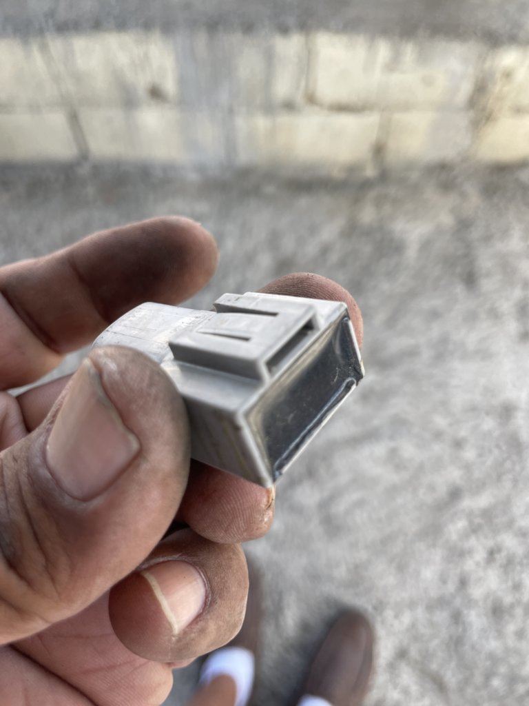

    In my Tacoma 2015 prerunner 2.7L by the 3rd spark plug from the front there is this thing, i don’t know what this is for anyone with info please help

    Looks like a waterproof plug for some unused connector.
    I've not seen one of those on my 2015 4.0L V6. Perhaps it's something on a one-size-fits-all wiring harness that is used on the 4.0L and not on the 2.7L.

    Pretty sure thats the noise suppressor for the ignition coils, it needs to be plugged in.

    Electrical condenser (aka capacitor)
    Google Lens finding (not necessarily the exact same PN: https://www.ebay.co.uk/itm/131525886023

    He is correct.
