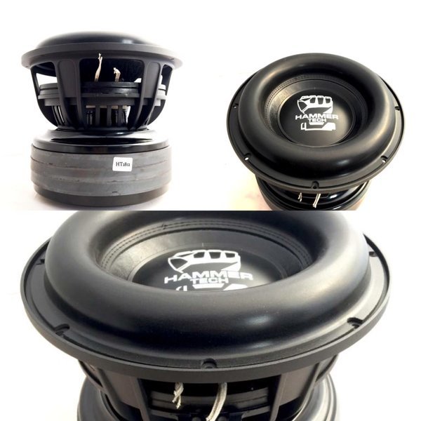

    I have access to a variety of mid bass speakers but the reality is you need to deadener those doors. Seal those doors up so its a true IB setup. Toss some power on those mid bass drivers, cross them over 60hz. Toss a nice big sub in the back, give it some power and away you go! IF you like SQ but loud build a TL or 1/4 wave box. My trucks getting 4 of our New Hammer tech 2812s, 4 inch voice coil with huge xmax on 2 8.8k Soundigital amps. Dual Alts etc :)
    A single one of these subs will daily all day long with 5-6kw of power. It was designed and built to ground and pound all day long. As for history of the our Hammer tech line.... its the subs used in the loudest EVER db drag certified score !
