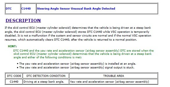

    can anyone explain what happens when it kicks in?
    Mines new only got 112km on it. Not sure if this was hill assist or something to be concerned about.
    Leaving my grandmothers today (house is on a hill) backed out of the driveway onto the hill (its steep)
    as soon as I went from R to drive I heard the truck beep, had some yellow triangle with a ! in it come on, and pushed the throttle.
    Didn't get any other message on the dash just beeped then had the yellow light come on for a second. I put my foot back on the brake as soon as I heard it beep not knowing what the fuck was going on, light turned off right away and then I hit the gas and took off. Nothing else happened.
    I did notice as soon as I put it in drive it felt like it was about to roll back then just stopped. really was not sure what the hell was going on.
    Thought hill assist was only for manuals
    mines 2017 TRD off road automatic.
    Just not sure if this is something I should be going to the dealer about or normal operation.
    Happened so fast had no clue what was going on, and here street is known for dumb fucking cunts flying down the street towards the hill where they can't see you, so its one of those spots always try to get in gear and get going right away.
    Seen plenty of accidents there, all the people on here street keep trying to get teh city to put speed bumps in to slow people down.
    hard to tell from google maps but ya, its a steep fuckin hill

    Nothing on dash on Sport models.
    Off road/pro models use their crawl/MTS systems for hill assist functionality and will almost certainly show something alert~y on the dash.

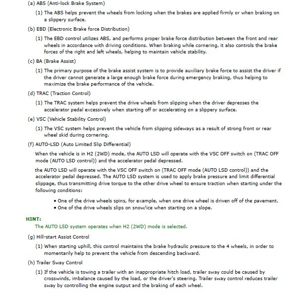

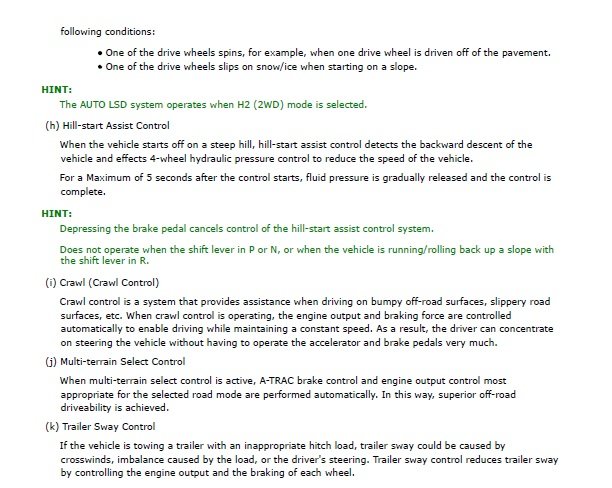

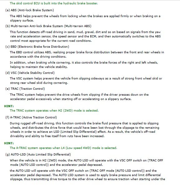

    HYDRAULIC BRAKE BOOSTER
    VACUUM BRAKE BOOSTER
