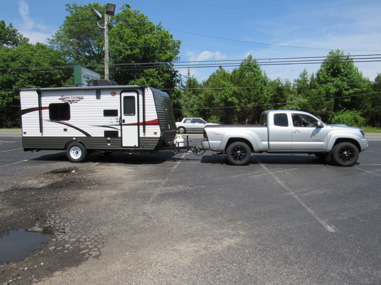

    I wouldnt tow that without using a WD hitch...I have almost the same exact camper
    If u ever need to swerve to avoid an accident the wd hitch makes the rig feel as one. It will be a better safer towing experience using a good WD hitch. Im using the fastway e2 and I love it! Very easy to hook and unhook,and u can use it in reverse. $299 on etrailer for the #800 setup.
    Here is a pic of my tacoma with my new sportsman toy hauler using the fastway e2 hitch. My truck is sitting fairy level...Im not using any suspension upgrades accept I had the leaf tsb done. Dry hitch weight is 420# ,Dry weight 2600#
    all loaded up last weekend camp we were probably had 400# gear so were at 3,000 ready to camp. I can feel the trailer back their for sure but it tows very nicely...On 50mph or under roads,I keep tacoma in 4th gear
    Your gonna have wind resistance no matter what with towing these box shaped campers. Just take it slow and steady

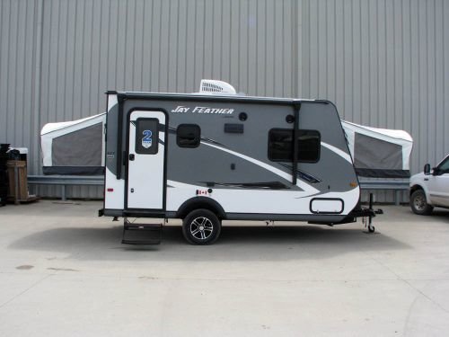

    Can I tow this comfortably with a 2015 DCLB
    2017 Jayco Feather X17z
    Unloaded Vehicle weight - 3085
    Dry Hitch Weight - 400
    Gross Vehicle Weight Rating - 3500
    I have read a lot but just want to have a second opinion on this. Thank you

    Probably. A little more info on the towing vehicle. Also check out the towing section of the forum.

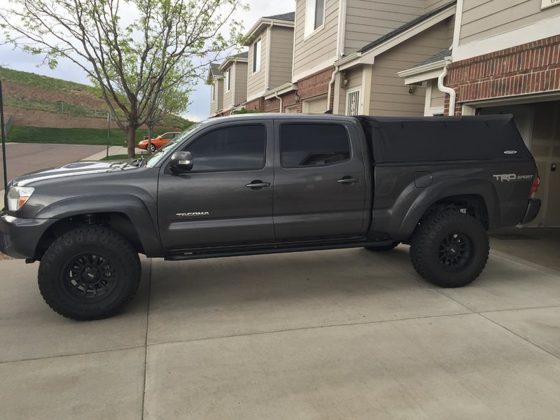

    I have read a ton of the threads on the towing section. It seems like everyone has a different thought on what is safe to tow. I would be using a WD hitch as well as breaks.
    Here is the towing vehicle
    Thanks!

    Assuming you have the towing package, you're ok. If you don't have any towing experience, do short trips at first. Use 4th gear.

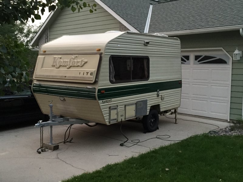

    We keep it classy in MT. 1985 Komfort, we just call her Karol. Tows like a plywood box with a sail. image.jpg

    I checked and do have the transmission cooler so confirmed the towing package. I use to tow a motorcycle trailer all the time with my 2009 DCLB sport but it was much lighter.
    I'm also at altitude...and most of my camping is around 10,000 feet...assuming I will have to stay around 50-55mph on the inclines.

    Sounds like fun towing (been there) Looks like a nice unit.:thumbsup:
    Sounds like you're good to go:yay:

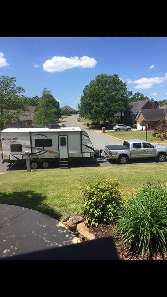

    My 2007 Tacoma with tow package is pulling a Prowler Lynx 22LX. I have a weight distribution hitch sway bar and brake controller. The dry weight is 4300 lbs and the tongue weight is 524 lbs. My Tacoma tows this well. So far I've just been making short trips braking and hills haven't been a problem. Later this month I'll be making a longer trip from Arkansas to the Georgia coast.

    impressive ArkTraveler...

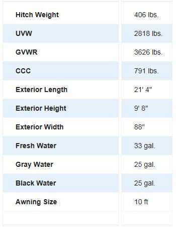

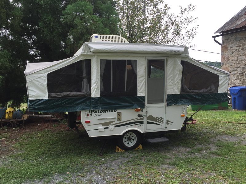

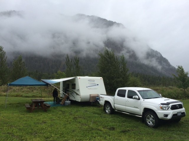

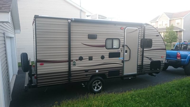

    Just picked this up

    what model is it?
  19. Jul 6, 2016 at 6:49 PM
    #459
    maxpower29
    maxpower29 Well-Known Member
    Mar 7, 2011
    #52525
    8,036
    Jordan
    Nova Scotia, Canada
    2011 Tacoma 4x4 2.7 5 speed SWB
    All season mats, 2nd filter delete, DT header, Jardine cat-back, URD shifter, Bilstein 5100's all around at .85 front with Eibachs + .25 passenger/.5 drivers spacers and 1.5 AAL, 0w20 synthetic, Scanguage II, extra D rings, OEM backup camera+Mirror, bed mat, Extang Solid Fold, Popnlock 5300, Pro Comp 7089's 4.5bs 285/70/17 Revo 2s, De-badged
    Mine?
    2017 Cherokee wolf pup 16bhs

    nice rig! you using wd hitch? any rear suspension mods?
