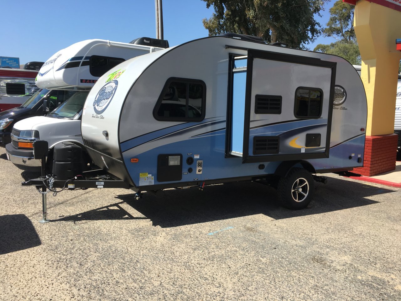

    After months of thinking about fixing the extensive dry rot in the roof of my '89 Coleman Sequoia tent trailer I just this week decided to trade it in and I bought a new (2018) rPod RP-180 that is fully loaded!!! I pick it up on June 2nd.:)
    Will I need overload springs for my 2011 PreRunner? It has the factory tow pack.

    Looks nice!!!
    I was thinking more of Hellwig overload springs. I had a set on an F150 in the early 90s when I was carrying an Alaskan camper. They made a world of difference and are cheaper than air bags.

    Awesome! Thanks for the tip. I pick my trailer up in a week. I'm going to see how much the rear of the truck drops with the trailer tongue. (Tongue weight I believe is 340lbs.) I would rather go with overload springs than a weight distributing hitch if I can help it. I remember with my 2002 5 lug Tacoma Extracab the rear would sag noticeably when I hitched up to the tent trailer. People would always flash high beams at me at night because my headlights were pointed up. Also have to have a brake controller installed. The RV dealer suggested a digital control unit for $100. I've never used trailer brakes before. Another learning experience I will go through.

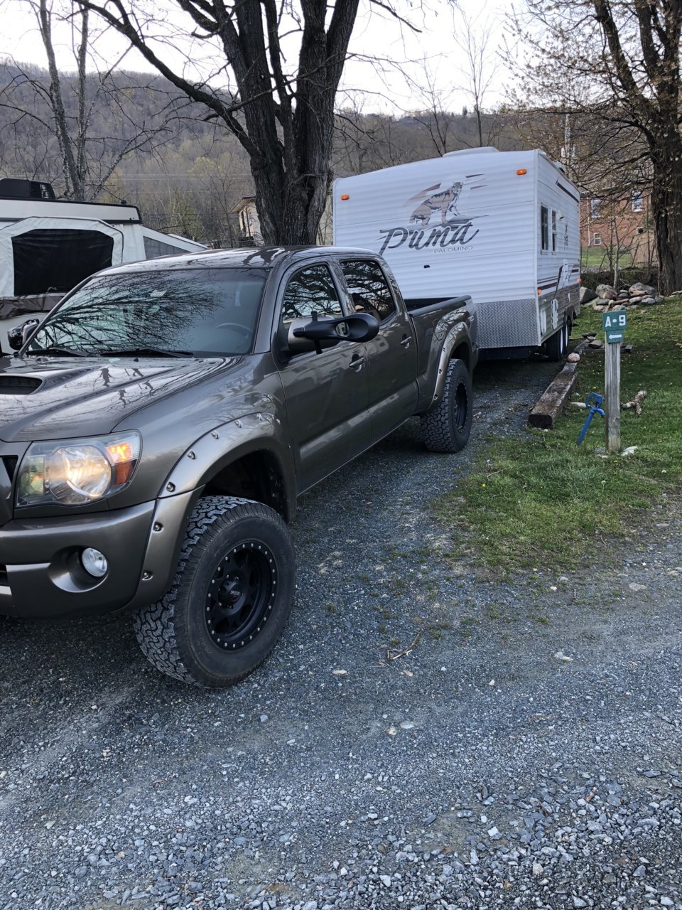

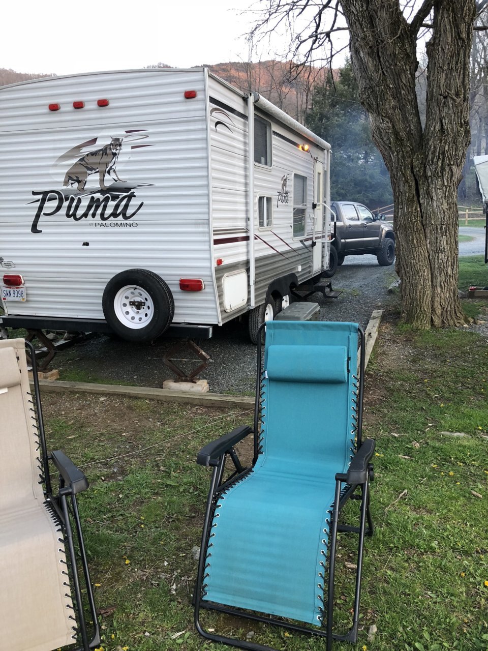

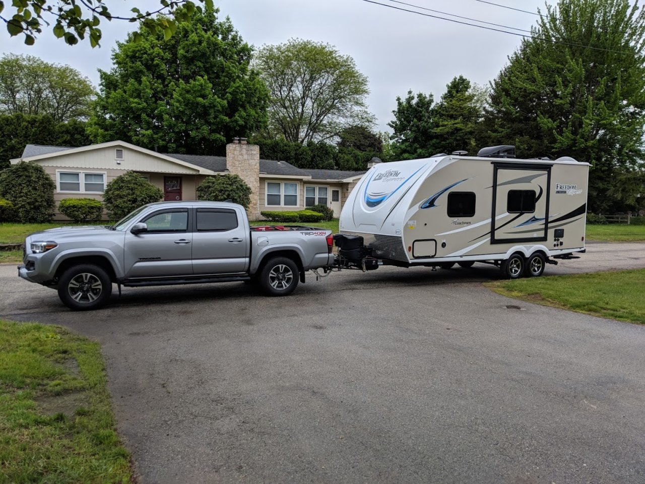

    We own a early 2018 of this same exact camper. We love it. My 2016 OR LB auto pulls pretty well. I do feel it at 65mph but nobody should be pulling anything faster than that anyways. I also went with the Anderson WDH which is pretty awesome. 5 quick turns of the leveling nuts and Im perfect. Loaded and wet I'm at 4500# give or take depending on what I'm bringing along. The P3 brake controller set to B1 is my preferred setting. I also went ahead and got the Dometic mirrors. I tried the varies strap on mirrors and hated them. And for shits and giggles, added a wireless rear camera. I only use it to see what is behind me. Also using Torque Pro to monitor tranny temps. Coachmen does an excellent job with this floorplan. Fit and finish is a little better than the others and resale value should be way better as well.
