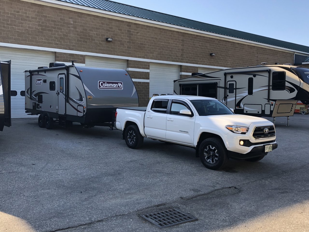

    Looking at a Starcraft Autumn Ridge 20BH. Dry weight of 3862. I initially wanted something in the 2900-3000 range, but this deal came available. I like the dual axle over single for sure.
    How would my Taco handle this? Planning on using a Husky Center Line 6000lb WDH.

    ktmrdr
    ktmrdr Well-Known Member
    Aug 26, 2015
    #162756
    417
    Awesome trailer. How does the Tacoma do pulling this? It looks like it weights 4500lbs dry.
    Jaybird Tacoma and Casper66 like this.

  14. Jun 20, 2018 at 11:06 AM
    #794
    atrain23
    atrain23 Well-Known Member
    Jun 4, 2018
    #255473
    64
    Alex
    New Hampshire
    2016 Tacoma SR5 DCSB V6
    TRD off-road wheels
    Thank you really loving it so far! It pulls it great, I was pleasantly surprised by how well he truck did. I pulled it home with a full fresh water tank. I took it last weekend to local campground to try everything out we had a great time.
