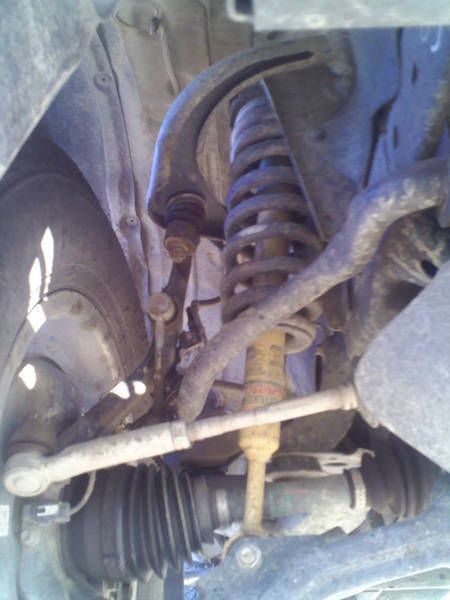

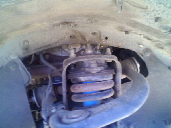

    So i bought this truck in June and haven't done anything to it. It came with what I was told is a "leveling kit." For whatever reason, I noticed just recently that I have a little tire rub when turning. It's seems to be worse when backing up and turning. The front end sits a little lower so I am wondering if maybe the front settled. I am hoping that this is adjustable so I thought I would check here before going to the local tire shop. I think I currently have 17X265X70 tires. I'll doublecheck over lunch. Can anyone tell me what would be a good fix. Here are some pics:
    Thanks in advance for any help.

    You have a spacer up front and a block in the rear. They are not adjustable,but there are different size spacers you can buy for the front.

    Thank you. At least I can go in now with an idea of what I need; a bigger spacer up front. It doesn't look too difficult to swap that out. anyone know a site where the spacers can be ordered?
