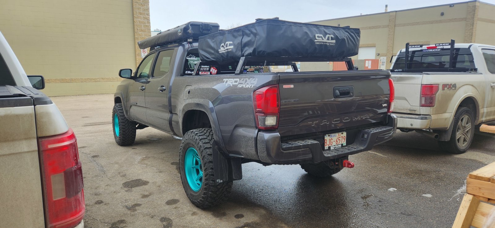

    That's what you get with a bit of weight on a damn near leveled truck. Those OME mediums settled a long way and handled no weight.

    I'm sure it will settle a bit but those dobinsons 112's handle the weight muuuuuch better.

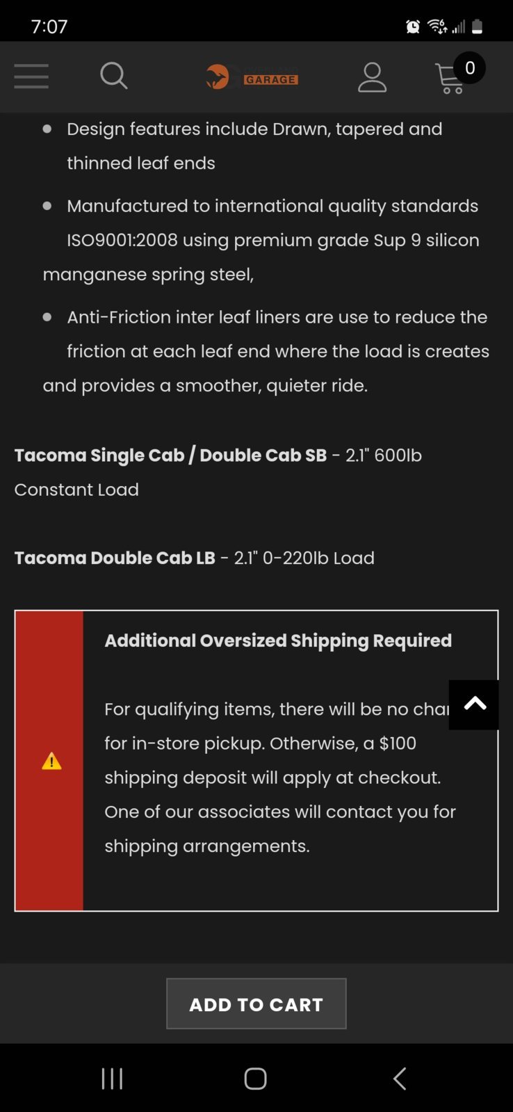

    111 or 112? I found it interesting that dobinsons lists very different capacities for the DCLB vs DCSB. The 112 on a lb is 600lbs on a sb I think it was 800-1100 or so

    I’ve got the 111s, so 0-200# of constant weight. That’s exactly how much my RTT and bedrack weigh:
    Yes I did notice that with the 112s as well. Makes no sense to me.

    Even for the 111 they register seperate weights. The 0-200 is LB specs 600 on SB. Did you find much settle with yours?
    Regardless if that's where it sits fully loaded it looks damn near perfect. Still has maybe an inch of rake to it.

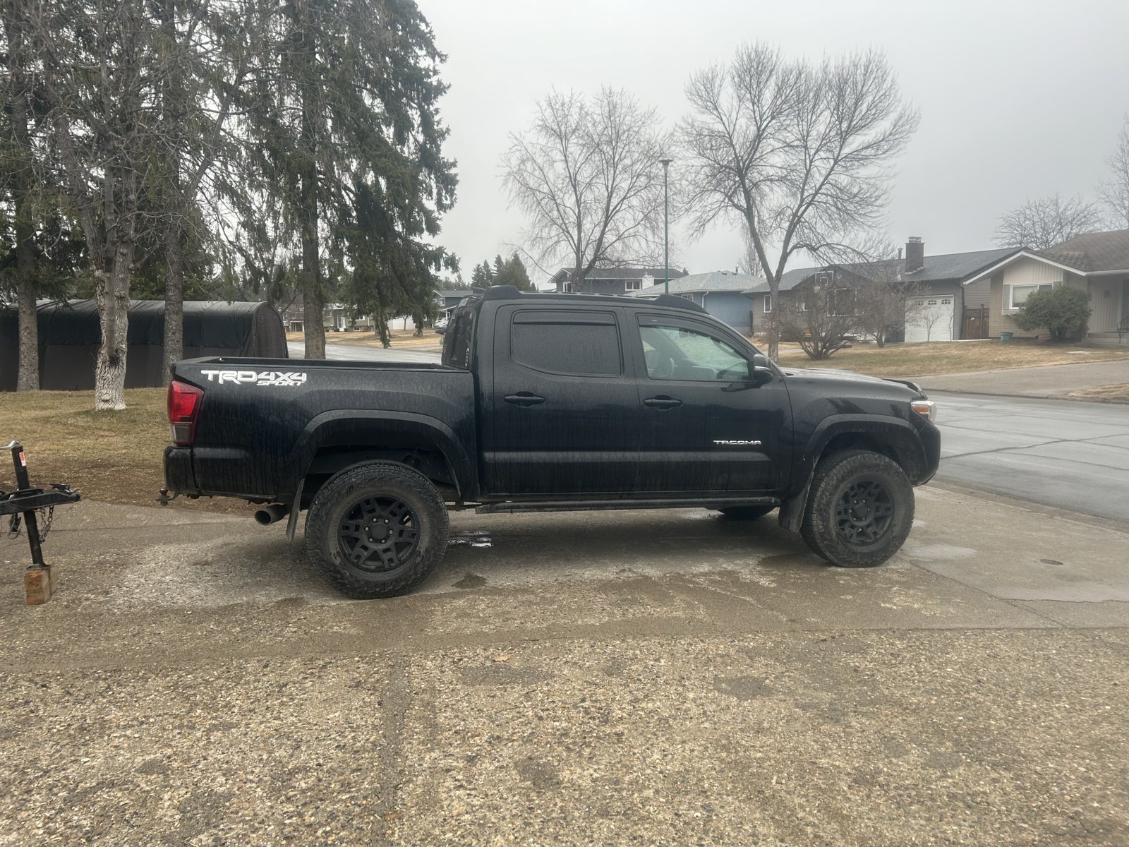

    Oh what?! Well that’s some good news! Still though, makes no sense why such a large difference.
    I honestly never measured but my trucks looks the same to me as it did 3 years ago.
    The day lift was installed. Mind you truck had 265/70/17 tires:

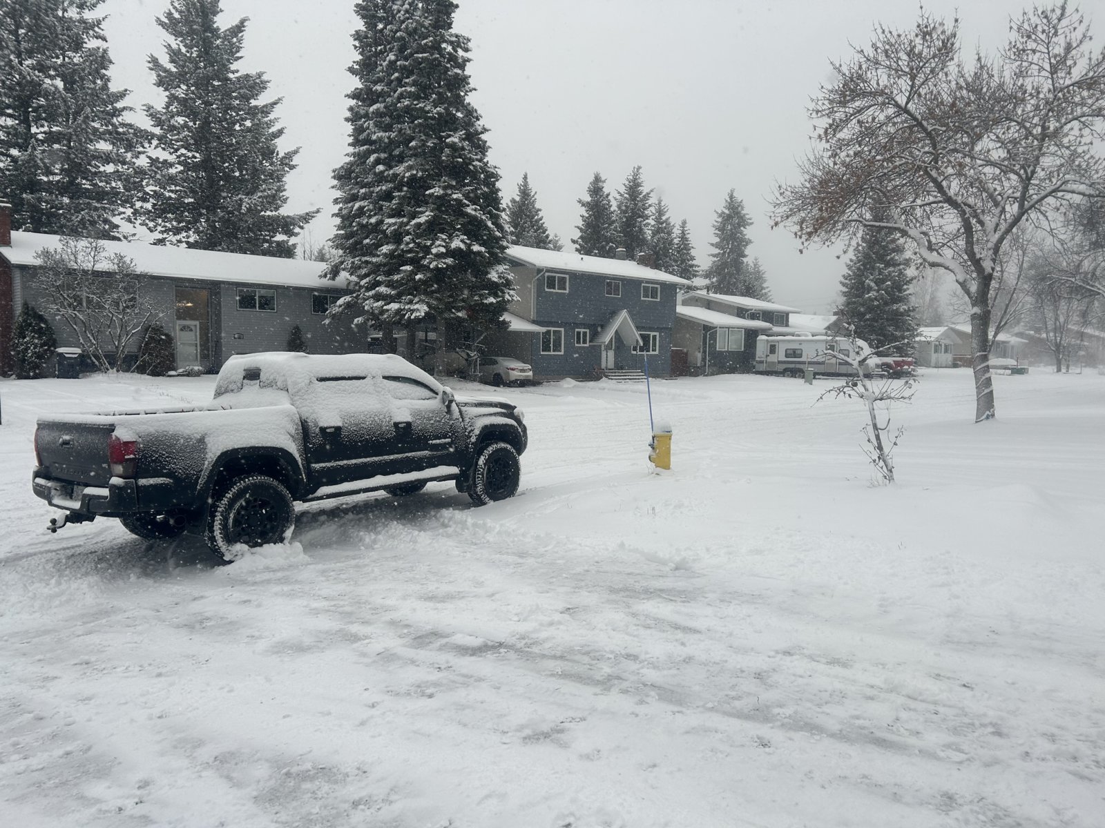

    This one is a pretty recent pic, 255/80/17 tires:

    I was banking on it settling about 1/4-1/2" but the ratio looks identical between the 2 at new.
    But besides the tent I have very little weight in the bed currently. Ride quality has been far better than expected so far. I expected it to be super stiff with very little small bump compliance but doesn't seem to be the case.

    I don’t mind how it rides unladen at all. Of course with some weight in the back it’s better. The only time it squats is when im completely packed with camping stuff and food/beers. I would say at least a 800 pounds:
    Just took these 2 pics. Right side of truck seems to have a bit more take than left. Prolly a bit uneven driveway:

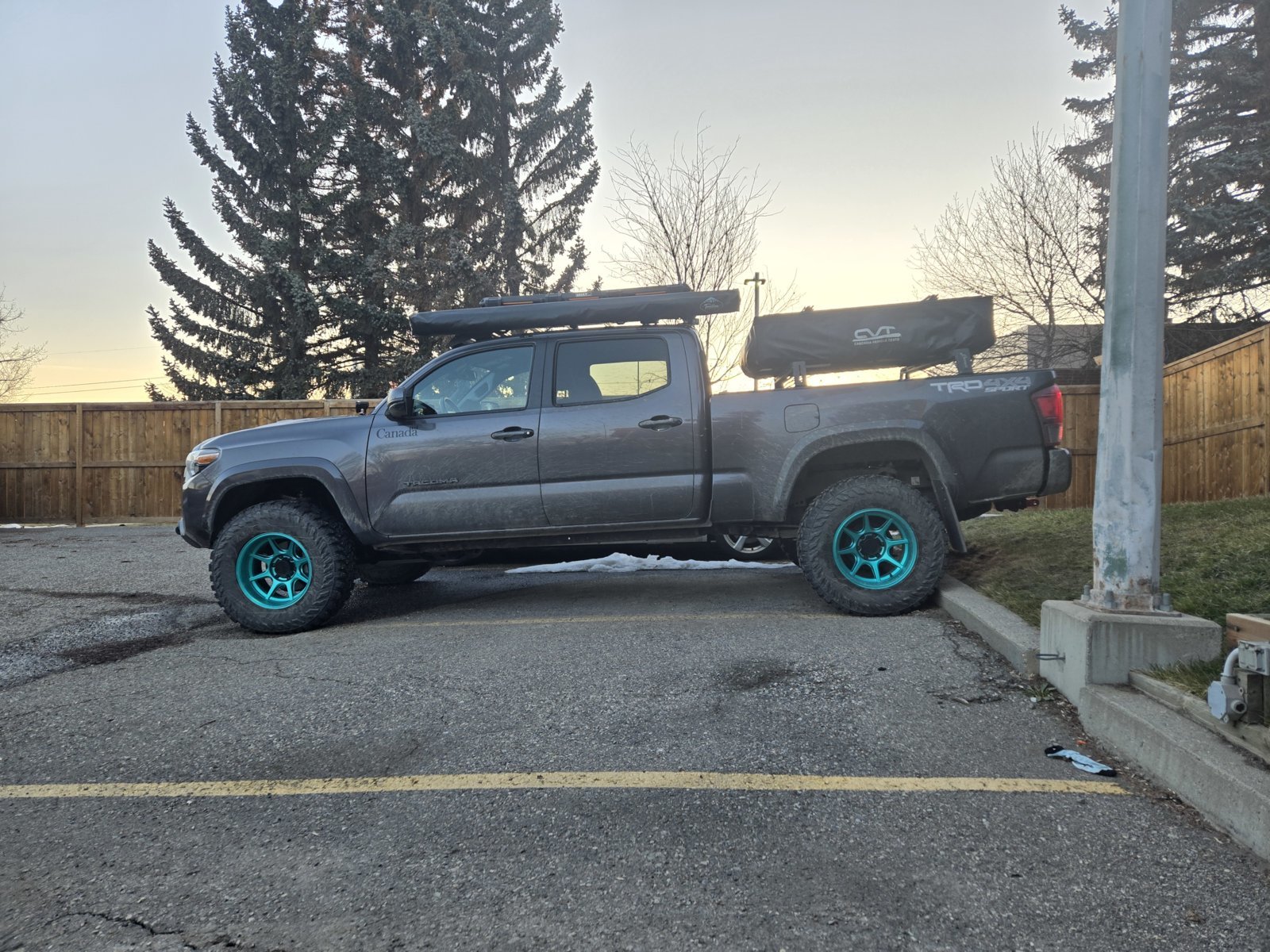

    Mine does the same in my parking spot left side sits much lower than the right but on even ground it's much closer.
    If mine ends uo comparable to your height with just my tent I'll be happy. I'm a but annoyed I forget to get a before and after measurement but it's easily 2" higher than before and with the weight shift my front sits a good 1/2" lower.

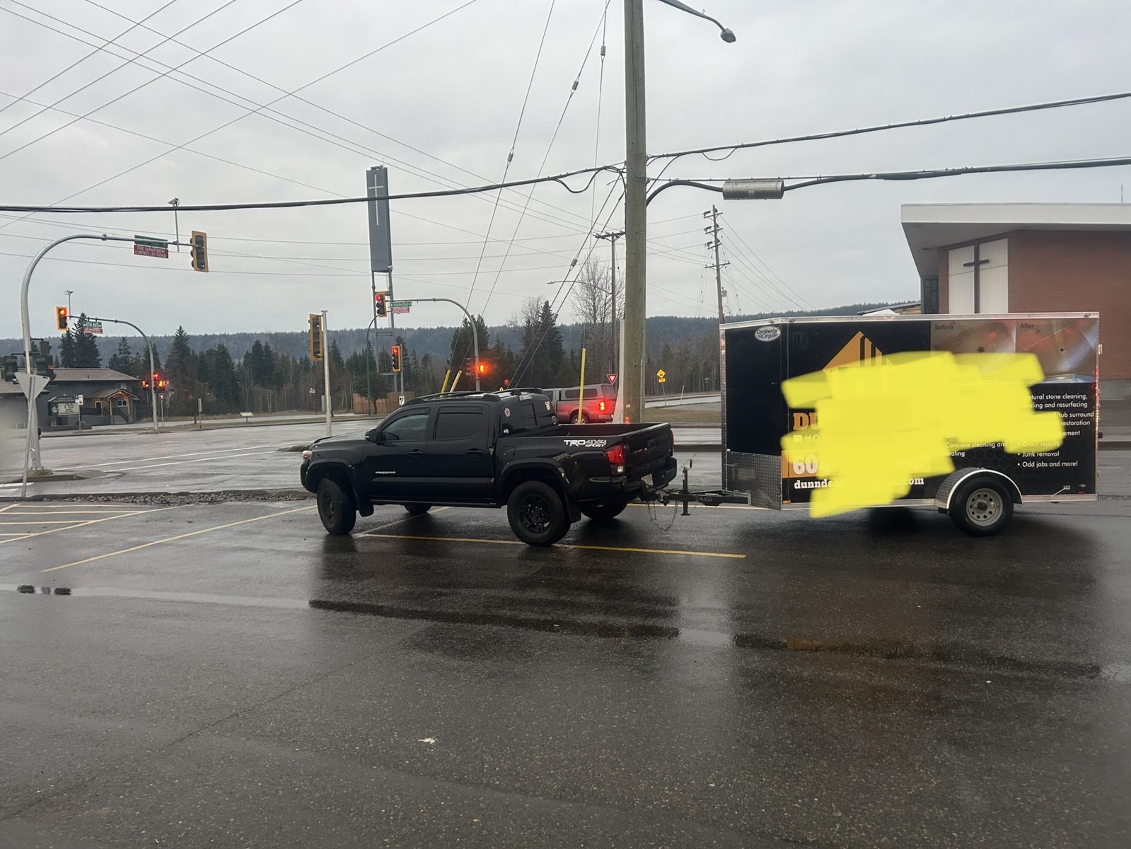

    wtf......lol

    sorry about the graffiti on your trailer.....those damn taggers
