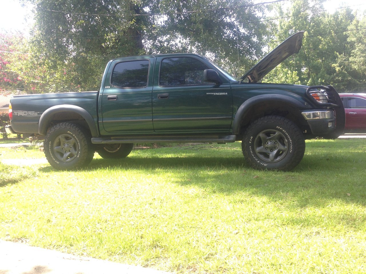

    I just had all of my suspension reworked and redone about 6 months ago and went with Bilstein 5100's and new front springs. I also have a Toytec AAL in the rear that I have run for probably 10 years and have been very happy with. I don't do heavy off roading, but I do take my truck down 4 wheeler trails, cross creeks on my land, go to the duck camp down rough ass roads and I'll hit a mud hole on occasion. I love the bilsteins for what I do. I got them for 199$ shipped for the fronts to replace my worn out KYB's/Toytec spacer lift. I think for the price and what I do they are perfect.

    Here's my Icon stage 4 minus front resi's on 265/75r16 and SCS F5s.. couldnt be happier:

    What tires are you running? Did you do the bilsteins and coils at the same time or not? I have bilsteins with an aal but I don't have new coil overs. I'm thinking about getting some to upgrade my setup a little
  14. Aug 29, 2017 at 11:29 AM
    01GreenTacoma
    01GreenTacoma Well-Known Member
    Jan 9, 2017
    #207086
    848
    I'm running 265/75/16 BFG KO2's. I did the coils and 5100's at the same time.

    I'm not sure what the measures are in the rear, but in the front I am sitting at 38/1/4" from the ground to center of the fender flare on passenger and drivers side. I have a wheelers 1/4" top plate spacer on the drivers side to account for the lean.
