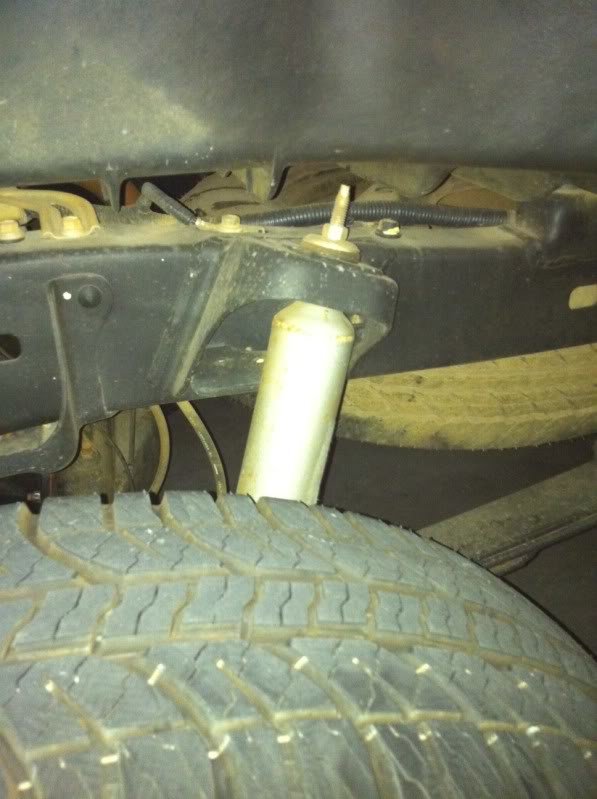

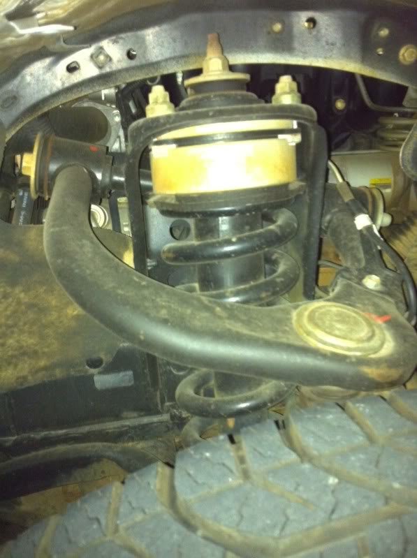

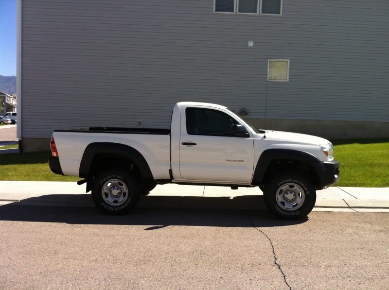

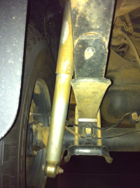

    Hi im new to here and i just bought my tacoma yesterday. I am very new to trucks. I was just wondering if someone had an idea of what kind of lift i had and how high it is from stock?
    340810_10150288102162530_539627529_77664_3126f2a9d937fd4afde9b47d24a10f0d743448be.jpg
    FRONT
    REAR
    REAR

    The front is a combination of a coil spacer and a top plate spacer.
    The rear looks to be a small block I think....it's hard to see.
    How many leafs do you have in the back?

    I don't recall Dave's having it on them when I pulled his off, so...........:notsure:
    I'd be inclined to agree with the KYB also.

    All the toytec spacers I've seen have toytec engraved on them.
    Anyways it's not important. No one hunk of metal jammed into a coil assembly is better than another....

    thanks guys! is this a decent setup?

    It's "ok". There are better options out there. Biily's and Eibachs or an OEM set up will give you a better ride.

    No not really. It's about the worst type of lift there is actually.
    That coil spacer with the stock shocks is going to give you a much harder ride than a nicer setup.
    And the top plate spacer allows your lcas to pivot too far down at full droop, which can lead to ball joint damage.

    If you don't do any off-roading and don't mind a stiffer ride, it should be fine though
