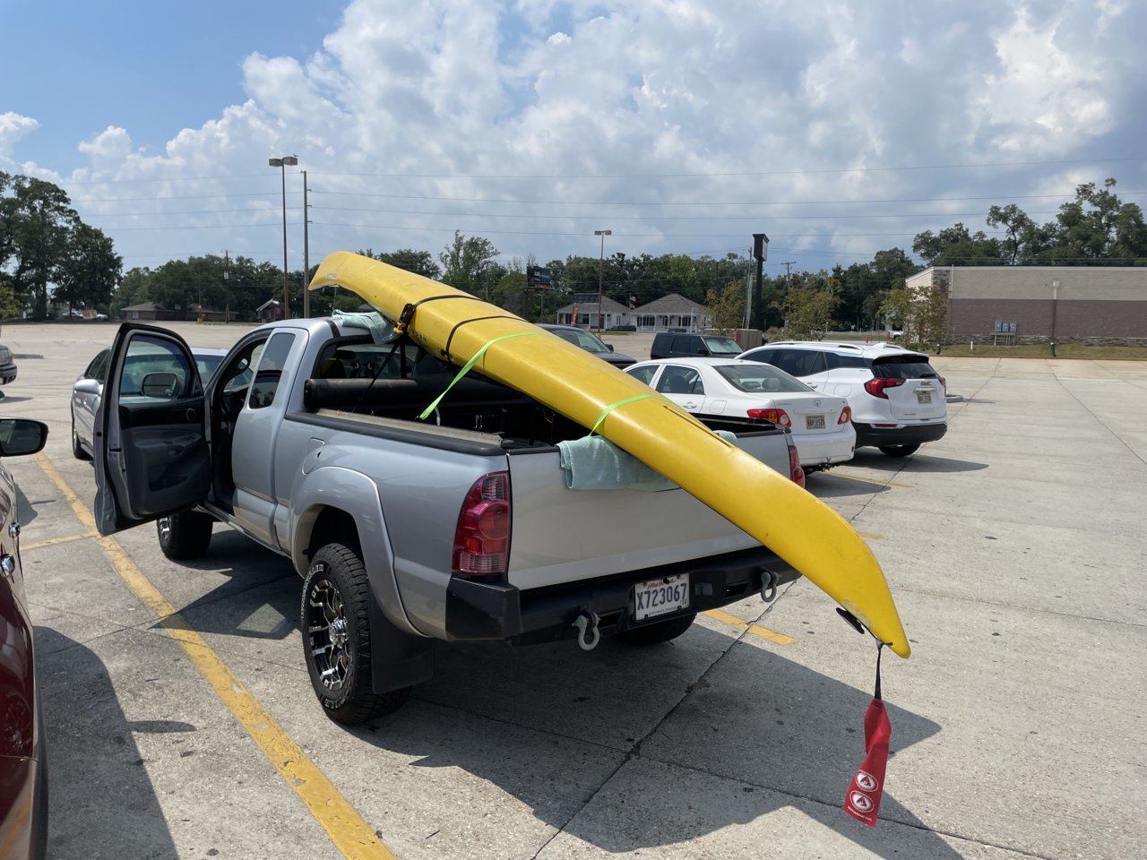

    I just bought this 16.5 ft ocean kayak, way longer than my 10 ft rec kayaks that I throw in the bed. The guy I bought it from had a t-bar in the hitch similar to this one in the link, but his gen 3 Tacoma had rails on the cab hood and he had a crossbar attached. I will probably get this t- bar, unless someone has suggestions for another solution. As you can see in my photo I have no rails. What is under those rubber tracks on the roof? Are they anchor points? Suggestions of what will fit on my gen 2 roof?

    Incidentally, this will be a good solution for my extension ladder when I go work on the rental property too, so looking forward to a good setup.

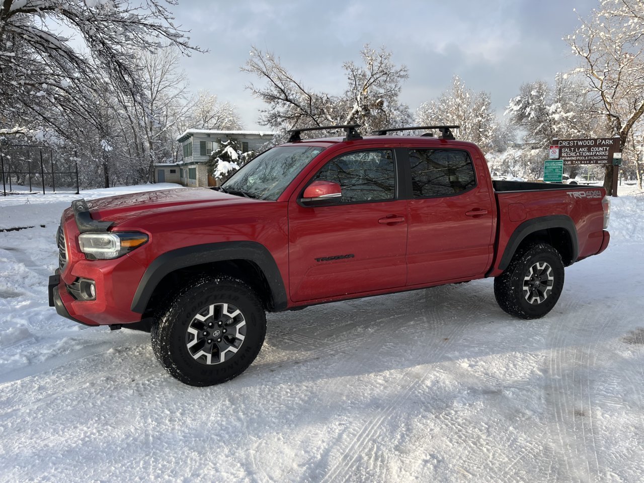

    Here’s mine with Yakima crossbars. You can use #24 landing pads like I did or get the mounts that click onto the doors. It works great with kayaks.
    I went with this solution because the Yakima bars are removable and I drive most of the time without them on.
    Other people have had success with Prinsu, etc.

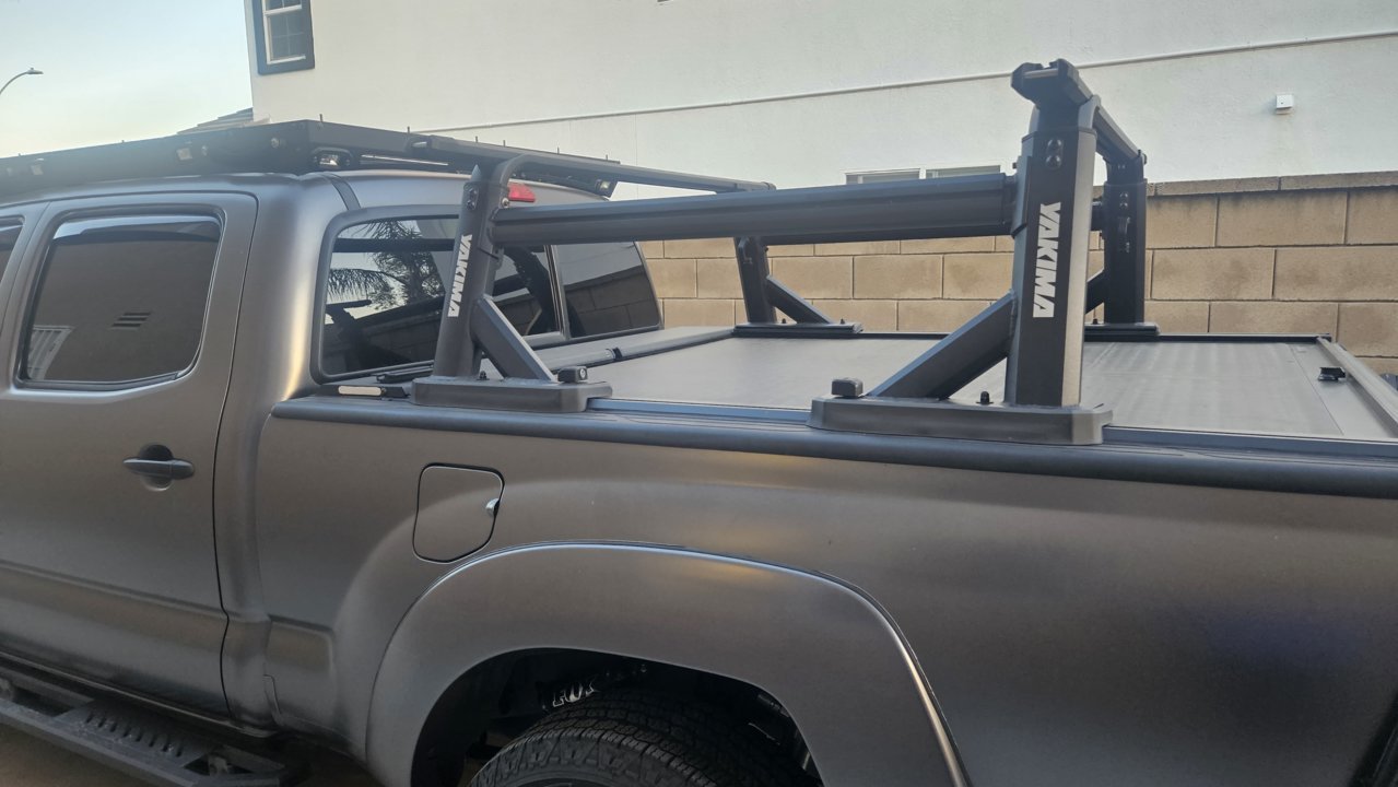

    Get a Yakima Overhaul rack on a tonneau cover with tracks. The rack itself is height adjustable
    novataco[OP] and Geeves77 like this.

    I like that and it would suit me well in conjunction with that trailer hitch bed extender because I could just throw them on for the occasions I am hauling the kayaks, or ladders, and take both the crossbars and the hitch extender off when not. I have a 2006 and I see you have a 2022. Do you know if your, or my roof, is a naked roof, fixed point roof or has tracks? I haven't looked under those rubber pieces but I am thinking it is a naked roof and the rubber is there just to cushion any aftermarket rack towers? How were you able to secure your towers without the door clips?

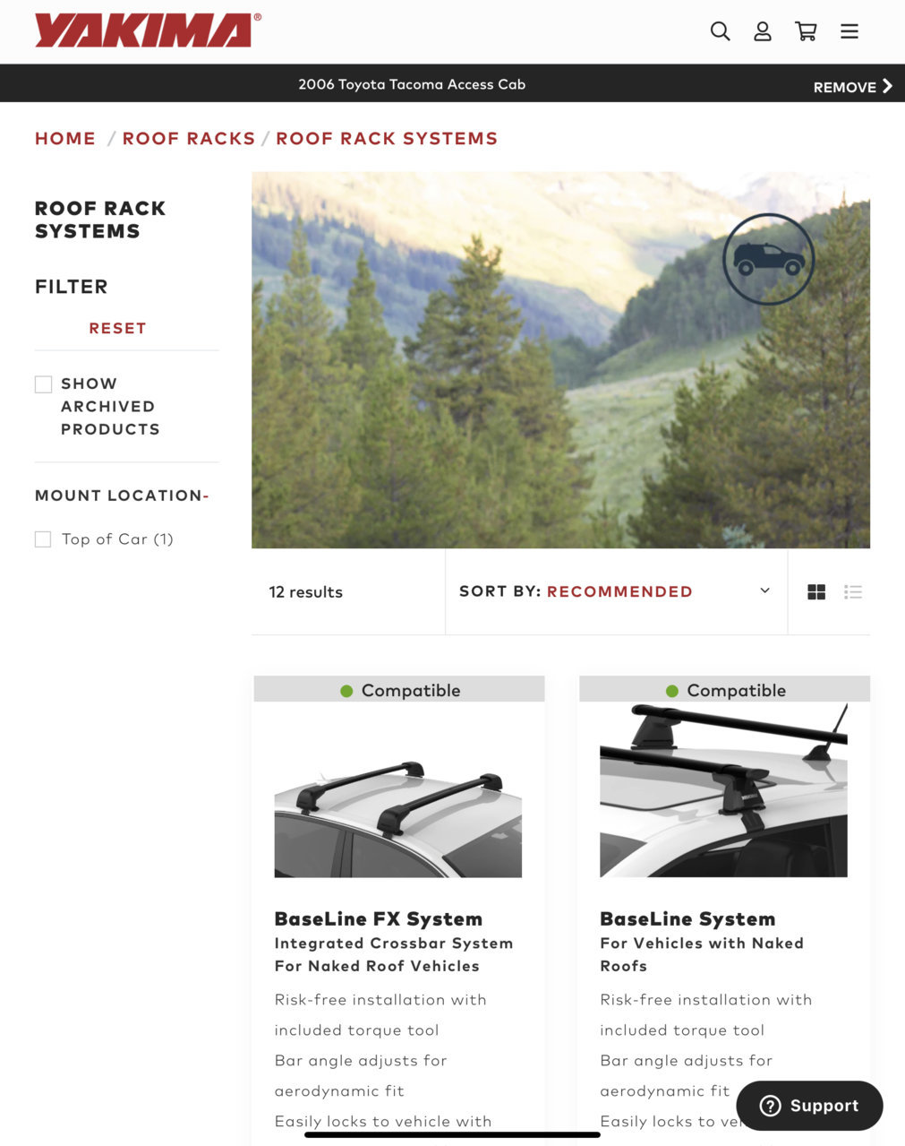

    I’m less familiar with the 2nd Gen, but on the 3rd Gen there are pre-drilled holes for attaching a roof rack underneath the rubber weather stripping. I assume the same is true for the 2nd Gen, not least because the OEM roof rack between the generations is the same.
    I did just notice, however, that you have an access cab and that will limit your options somewhat. I think the AC doesn’t have the mount points the DC does. I put in a 2006 AC on Yakima’s and it looks like the only things that work are the systems that clip in beneath the doors. I’m sure the same would be true of Thule and other manufacturers.
    That said, I’ve seen other people on these sites use the clip in system and it seems to work well. And of course you can take it off when you’re not using it.

    Yes, I came up with the same result. Strangely, I cannot add it to the cart. I am now on the Rhino Rack webpage and looking at their solution as well, recommended by Top Taco above. It would be nice to get one crossbar instead of a kit of two, as that is all I need.
