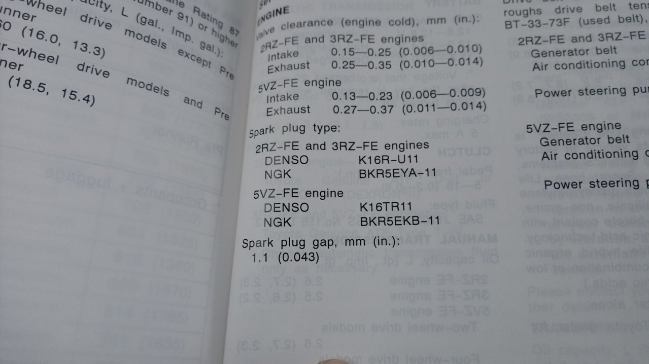

    Currygoat and Cutter_[OP] like this.

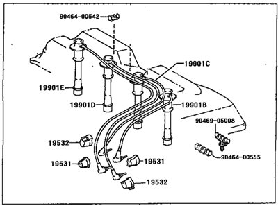

  14. Jun 13, 2019 at 2:07 PM
    DrZ
    DrZ Well-Known Member
    Dec 14, 2014
    #144262
    1,459
    Mesa, AZ
    96 2.4L 5-speed
    That's a diagram from the Toyota parts catalog. Either the website has the wrong diagram or the parts catalog used a generic diagram for all engines. Only the 96-97 4 cylinders had a distributor I believe, so it seems odd for that diagram to be used. But toyotapartsdeal is very good at verifying correct part fit by VIN. Seems like they interface directly with the Toyota electronic parts catalog. The only difficulty is verifying a part by name if Toyota gave it an obscure name.
  15. Jun 13, 2019 at 3:03 PM
    austinsdad99
    austinsdad99 Well-Known Member
    May 30, 2017
    #220261
    511
    1999 prerunner 3.4
    My v6 only has 3 plug wires that travel over to the driver side spark plugs. The other 3 are fired directly off the 3 coil packs that mount directly over the pass side spark plugs.
