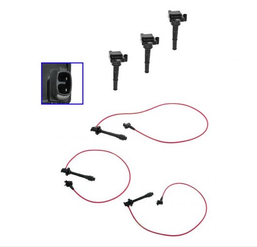

    Could you explain how the other plugs fired without a connecting wire? 3 coil packs yes 3 wires no. This is how that works the proper plugs fires as it should the other on the exhaust stroke they both fire at the same time next cycle it's reversed.

    The coil pack sits right over one bank on the V6. The 3 wires connect the coil pack to the other side
