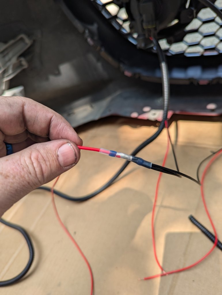

    I actually have no issues terminating with cheap crimps. I just have to be smart enough to keep a selection in stock so that I'm not terminating a 16 gauge wire with a 10 gauge crimp. :anonymous::anonymous:
    What I absolutely turn my nose up at these days however, is butt connectors. I hate butt connectors almost as much as I hate vampire taps. Line splices are solder only. I might be lazy enough to use the self soldering butts, but at least it's better than a crimp butt. :anonymous::anonymous::anonymous::anonymous:
    Kind of funny I'm in this thread after spending my entire Saturday kludging up wires. :bananadead:
