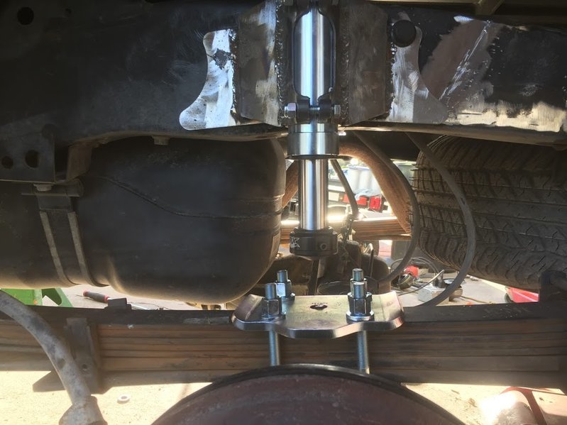

    Get the icon bolt on kit. Dont use the spacer. I just installed mine last weekend and i love it for unexpected dips or jumps. I have expo springs with unbolt flip. If you have a flip kit you need to order special bump plates

    any pics?
    They are not bolt on either unless you think getting 8 of these out I'd easy with a ratchet set...IMG_20170410_184706083.jpg

    its bolt on as you dont have to weld it on :D

    Yeah well I had a shop do it and it was still a bitch. Had to resharpen the impact chisel bit

    lol yea, removing stupid rivets sucks. will be doing that this weekend for my bumps also lol

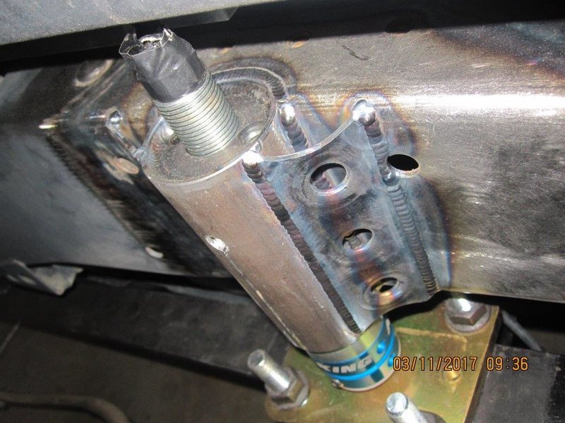

    @Mxpatriot Is correct...I'm running All-Pro leafs with 2" Bumps. The 4" is way too much:thumbsup:
