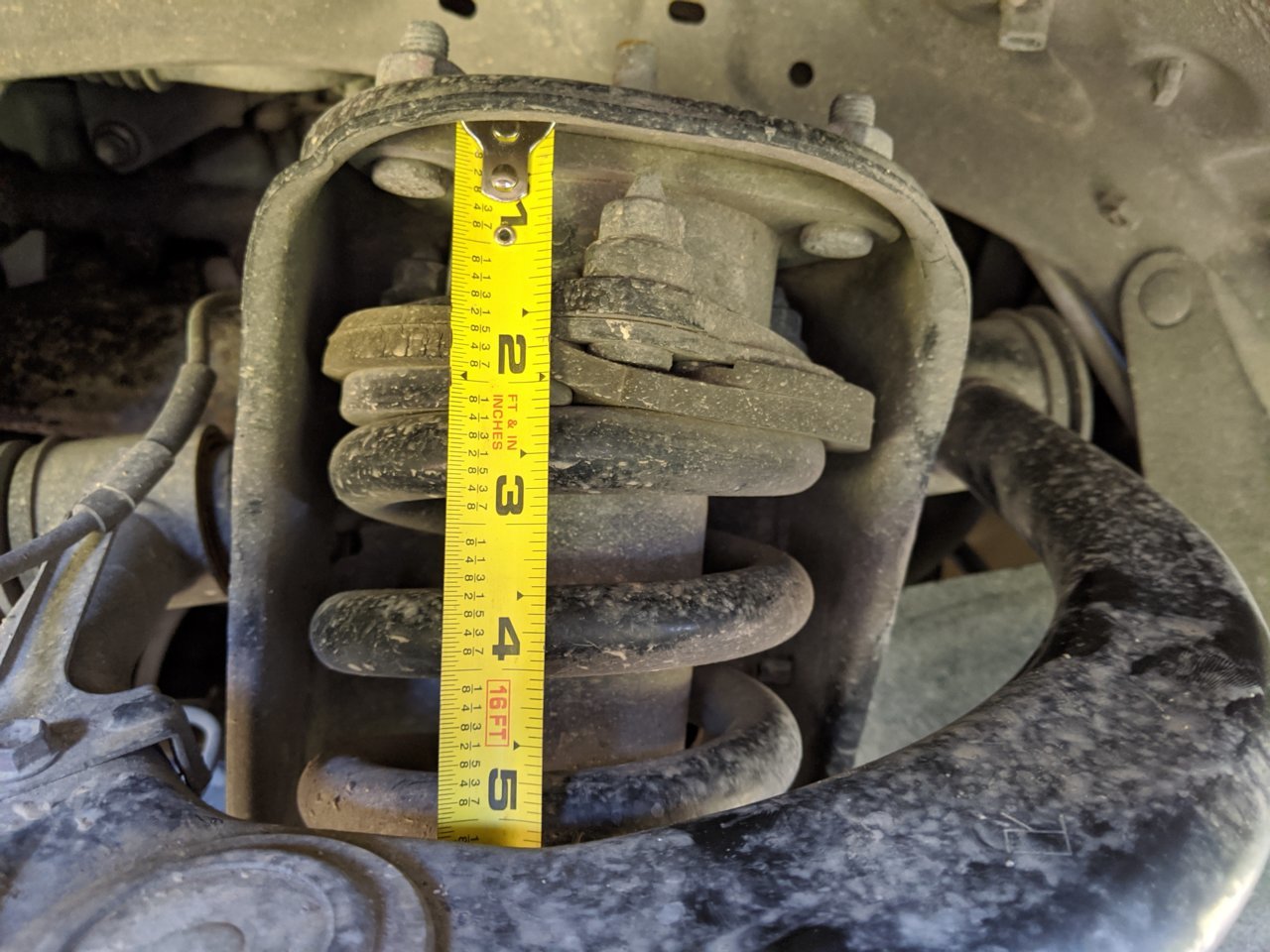

    I'm looking into getting a fox 2.0 suspension and didn't want to lower my truck as everyone says I have a 3inch lift in the front and the fox says it only supports 2 can anyone help since I can't see anything else that would be lifting me other than the spacer?

    Yup just a spacer.... if you get the fox set up, you should remove that spacer.

    So really that mean I have about a 2 inch in front and should be totally fine with the 2" that the fox provides so I can still clear my 33 tires

    The 1.5 inch spacer translates into 3 inches of lift.

    You can add a 1/4 inch top plate spacer with the Fox setup to get a little extra height. Your stock springs have also likely sagged a little over time. Even if you lose a 1/2 inch in ride height the ride quality from the Fox stuff will make up for that!

    Thanks for all the help everyone and just to confirm from the photos and measurements I have, I currently have a 3" lift? Also I have a second gen as I believe the third gens come with an inch already

    Looks that way based on the spacer being approximately 1.5 inch in height. So if you add a 1/4 inch top plate spacer with the Fox stuff you will get an extra 1/2 inch of lift... you’ll love the Fox 2.0 gear. I ran it on my F150 and my JK and regretted not going Fox on my Tacoma’s, ran OME & Eibach which were significantly better than stock but not nearly as nice as the Fox stuff
