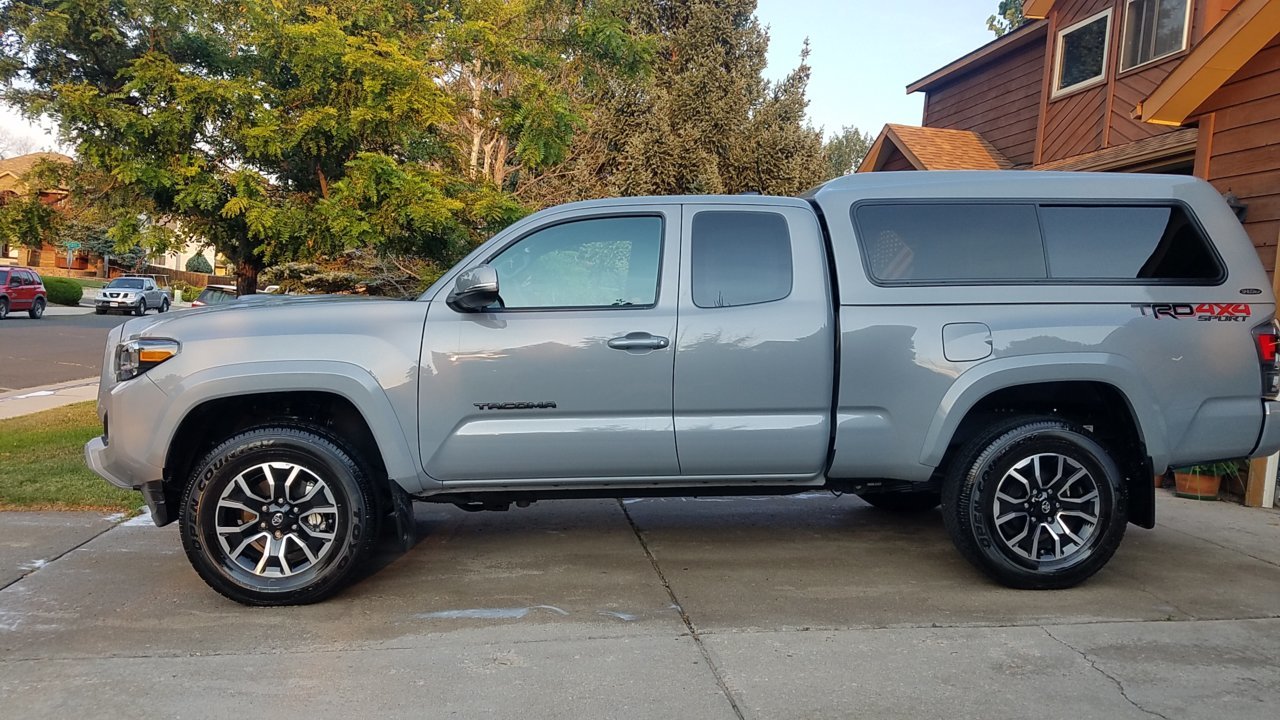

    A cap only weighs about 200 pounds. You shouldn't have much sag with that on your stock suspension. If you are doing a lift, you will be putting on a stiffer suspension anyway so there would be even less sag with that. Here is my 2020 with a Snugtop Highlander with the sportsman's package (adds about 50lbs).20200817_184826.jpg

    Does it maintain the factory rake with the cap on?

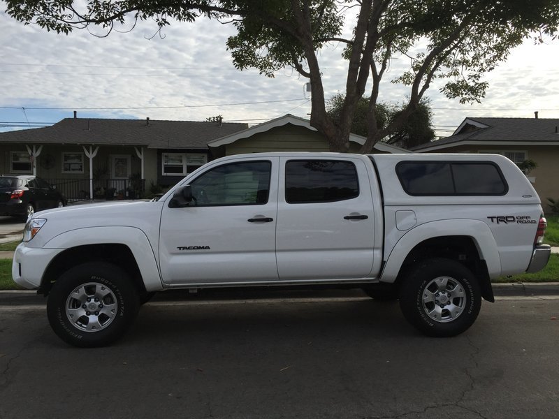

    Hey Vic, I have 2015 Tacoma with a Snugtop rebel "200LBS". I have a 2 1/2 " lift, Bilstein 5100's OME 885X's and OME Dakar CS047R medium Leaf Packs and OME CB drop kit now. 3 in back due to the Medium leaf packs and love it.
    I first put AAL's on it and it still sagged just with the shell. I put camping gear in the bed and two 100 lb dogs. It still sagged.. Then I invested in OME Dakar CS047R Leaf Packs and OME CB drop kit.
    I recommend changing the rear leaf packs, you will not be disappointed. :) the part number is different now but these pack are great the ride is great and I still dig the lift after 7 years.
    It does have a 1/2 rake that I like. No UCA's needed if you are under 3" of lift.

    Looks great on your truck but OP specifically said no more than a 1.5" lift. Dakars claim a 2" lift on the 3rd gen.
