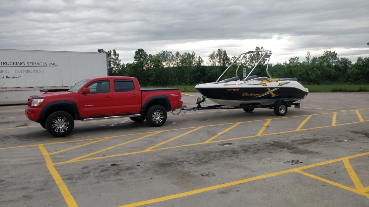

    Just bought the truck, 2008 150,000KM 4L 6MT. Already got new wheels dont worry.
    Hey Just joined, been reading some posts decided to share my tacoma on the sight, and see if anyone can help me identify what lift is on my truck.
    Looks like a spacer on the strut in the front and an add a leaf in the rear. Hoping someone can help identify how much its lifted, what brand lift, if the shocks are upgraded or OEM.
    Here is a couple pics of the truck, and the lift components.

    I thought spacers are suppose to go on top of the top hats not then other way around. But look like those are 2 or 3 loft soacers.

    69,757
    Shocks are OEM.
    Single leaf AAL and spacers up front. You probably have a 3” front and 2” rear leveling kit.

    '11 DCSB SR5
    OME 90021 with 885s and top plate spacer, 2" AAL, OME rear shocks, Camburg Uniball UCAs, OME CB Drop, 285/75/16 BFG AT's on Level 8 Guardian wheels
    This, on factory TRD shocks.
