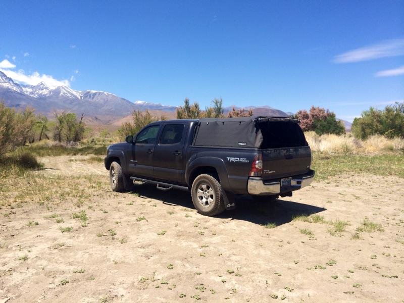

    I know this is more of a case by case basis depending on the person but I'm really going back and forth on my lift so figured I'd ask and see what others opinions are.
    So basically my truck is 99% daily driver and 1% fun. Most of my off road comes while I'm camping or just going out for a drive after a long week. The fact that it is my only transportation means I won't be beating it up off road or any crawling.
    Anyways despite that I want a lift for those 1% of the times I go off road and so I can put some bigger tires on for a little more ground clearance.
    Now knowing that what would you choose? The OME Full kit with 885s and Dakars or ICON Stage 1 with Wheeler's 3 leaf AAL? Both will most likely have LR UCAs unless I find a different UCA that I prefer for whatever reason.
    My original budget was $3000 for lift and rims/tires which the OME would come close to while the ICON would be around $500 more. While budget is a concern I'd rather wait and do this right if it would be worth it in the long run.
    And here is a picture of the truck:
