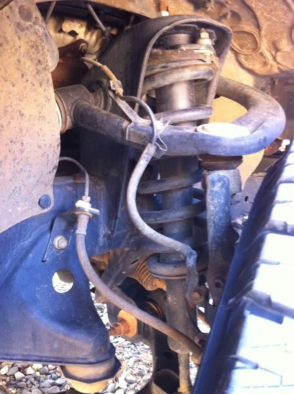

    I just bought this tacoma can anyone tell me what lift was used from this picture? I don't know anything about lifts and i don't know if the back is or not.

    Looked like a ready lift or fat bobs spacer lift

    its a readylift i bet, either way its crappy

    get you a set of 5100's and throw that junk away.

    No, seeing as how you have a top-plate spacer, the Billies will actually make the ride stiffer, because they preload the springs.
    But as others have said, they are a much higher quality lift than you have right now.

    with 5100s he wont need the spacer, so he can sell it/throw it away and just ride on the 5100s which will be a butt ton smoother than what he's got now

    Yes, but the ride will be stiffer, because the spacer he has now does not compress the coils.

    A "home made" lift. haha.
