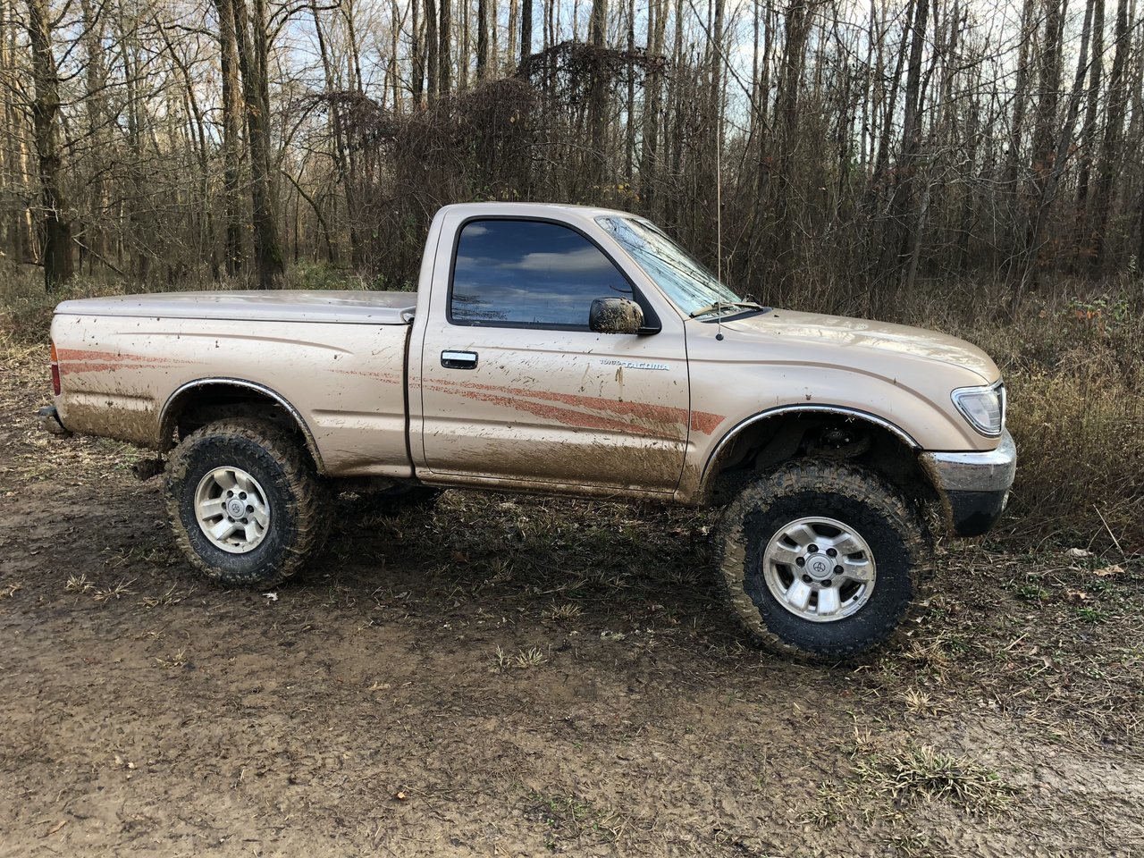

    7AA50248-EB49-4C57-9FD1-7FB3E9717DA6.jpg I just installed 3” boss lift toytec and highly recommend it. Installation was easy and ride is great . Cost is little over 1100 shipped

    Thanks Mdslawn. Were you able to install yourself?

    Yea for the most part . I had a buddy of mine help on a couple of things where Two people come in handy.

    What size tires are you running?

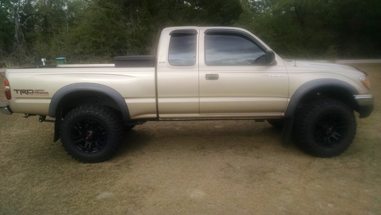

    Went with a rough country spacer lift for my son's truck. Not bad if you don't want to spend too much and only do light stuff off-road.IMG_20171223_144011008.jpg

    33x10.50-15 toyo mt
