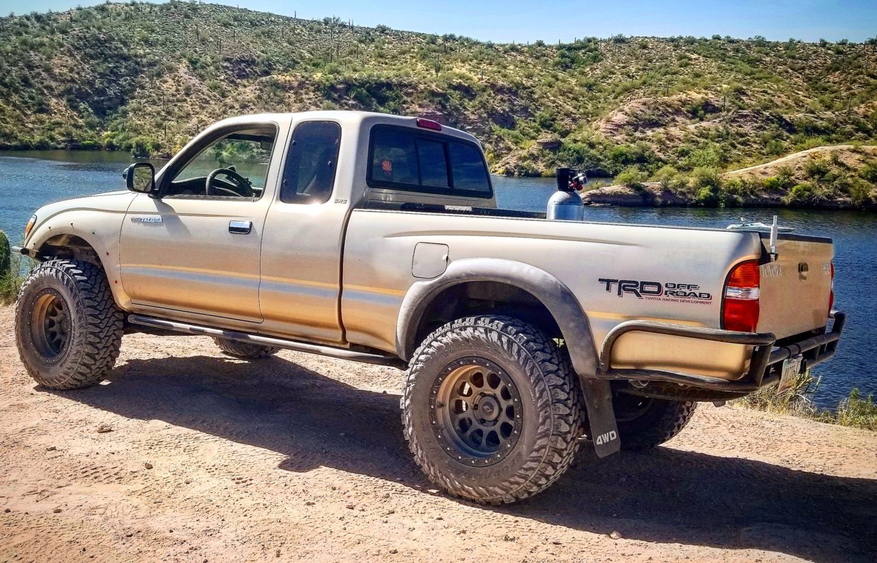

    So I run that size tire.
    I have icon coillovers but there not cranked very high. I'm about 1.5" over stock.
    I have to massage the inner fender pretty aggressively. But I have control arms that cause it.

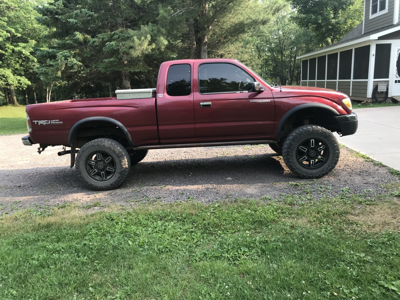

    I have the Tuff Country 4in lift. It clears 33s fine and would be a viable option if your not planning on doing any offroading as it doesnt give you any extra clearance. The tires in the picture are 31s but it stills shows how much room you have open.

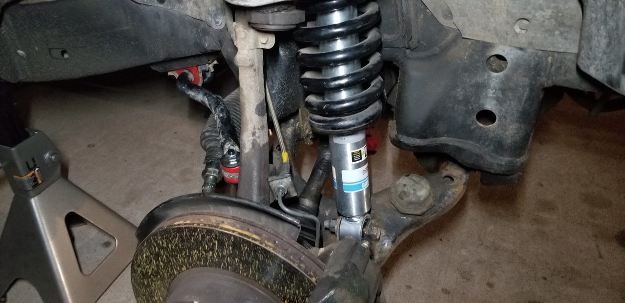

    Some bilistine adjustable and a block in the back is pretty cheap.
    http://www.sonoransteel.com/index.php?main_page=product_info&cPath=1_9&products_id=1
    Front:
    (2)-Toyota TRD Progressive Front Coil (48131-AF090 & 48131-AF100)
    (2)-Bilstein 5100 Series HD Shocks (24-261425)
    (2)-Toyota M12 Flange Stover Nuts (90177-A0012)
    (2)-Toyota Upper Front Shock Top Bushings (90948-01100)
    (2)-Toyota Upper Front Shock Lower Bushings (90948-01057)
    (2)-Toyota Upper Front Shock Top Bushing Retainer (90948-A2003)
    (2)-Toyota Upper Front Shock Lower Bushing Retainer (90080-94195)
    (2)-Sonoran Steel Fabrication L.L.C. Custom Polyurethane Top Plate Retainers
    (2)-Sonoran Steel Fabrication L.L.C. Front Differential Drop Spacers

    Awhhh mother fuc@%#$ !!!! I just typed out a long ass explanation and lost it !! Grrrrr!!!!!!
    Anyways. Short answer yes !
    Google sornansteel tacoma front lift. Should get a tone of hits.
    There tundra stocks bilistine will get you various lifts.
    Wheeler's got me the best price around by a pretty good margin.
    Shocks,upper control arms and spindles are all the same. You can use the lower control arms too but the swaybar mount is different. Can not use the lower ball jt or tierods.
    Here's what I just did it has a ome coils from a Tacoma.
