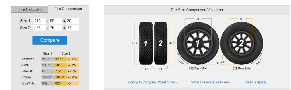

    Compared against my tire. My tire clears with room to spare.
    But then again, I'm running 255s with +4 offset. If you poke a 20" fattie out beyond the fender flare, there's no lift in the world that will help you. Not unless you only drive in straight lines.
