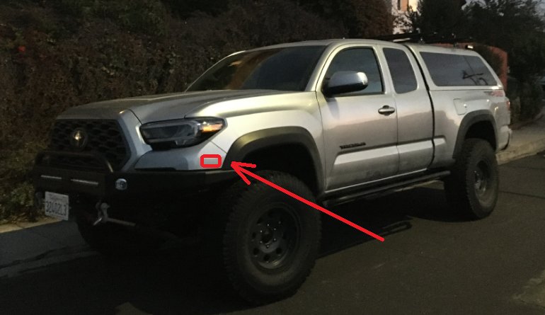

    I'm thinking of mounting a pair of flush mount Baja Design S2's in this location. This is more than the 45° recommended on the A-Pillar. But I really want a flush mount and A-Pillar lights are not an option for me. I just ran a test of the S2's in this location and the light from the S2 picks up right where the light from the LED lightbar falls off. I think it will work. Has this been tried? Is this idea dumb?

  7. Dec 2, 2022 at 8:23 PM
    #27
    panicmonster
    panicmonster no
    Jan 2, 2021
    #351509
    179
    Anchorage, AK
    2021 Mallcrawler Pro
    This is a novel idea. I love it. Adding to the list maybe mods. Good luck with it. Do post back if you decide to do it.

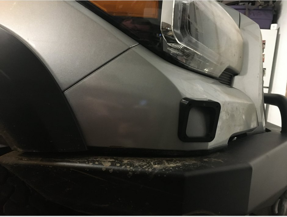

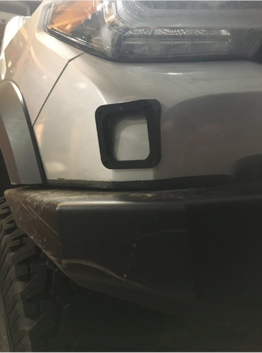

    I figured out that this location has metal brackets behind the plastic and started to work on how to move the S2 as far forward as possible. Ultimately I scrapped the idea in favor of mounting an S1 LED in this location instead and then actually mounted at 45°.
    I'm just waiting on some longer M3 machine screws to mount the S1s in this position.

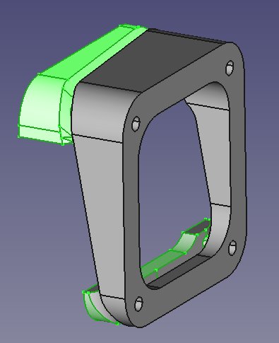

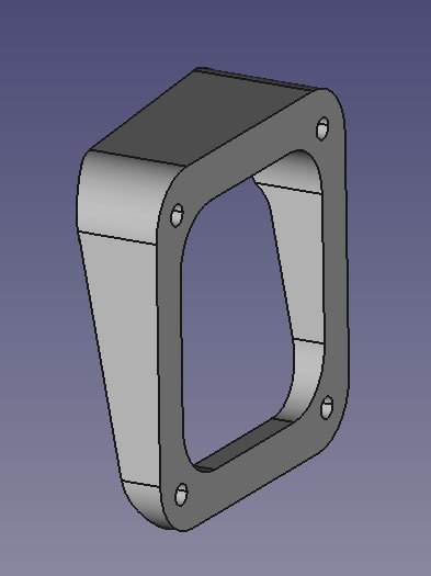

    I made the mount to fit the 45° facing aspect of the front bumper using my Prusa mk3s printer and FreeCAD software.
    Then to make a proper mount inside the bumper I made corresponding parts so the nuts on the M3 machine screws would fit flush.
    As for the S2s I planned to mount a pair at 90° by the A-Pilar anyway.

    Here's how the 45° flush mounted Baja Designed S1 cornering lights look installed. I had my doubts about these until I used last Friday night driving to my friends cabin. They fill in the corners with light right where the LED Lightbar starts to fall off. Combined with the LED light bar, the front is illuminated a full l180° now.

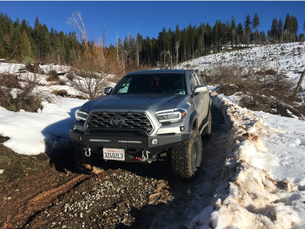

    Over the past few years I have been playing with my lighting set up as the truck sees alot of dark back roads on my fishing trips. Out here we see alot of dense fog and snow and deer.... Alot of this is simply for deer defense after hitting 3 deer with my old ranger.
    Starting with the basics I have piaa H9's in bolth low and high beams
    Current set up
    Roof-
    Diode dynamics 42" stage series with spot/driving clear lenses mounted on prinsu light bar brackets.
    A pillar-
    Baja designs squadron pro driving combo white on cali raised brackets.
    Bumper-
    Diode dynamics stage series 30" amber 3 spot lenses 2 sae fog lenses
    Fog-
    Diode dynamics ss3 pro amber sae fog
    Back of roof rack-
    Baja designs s2 sport white flood
    I set this up to serve 3 different functions. All lower amber lights are to be run in those low visibility situations to provide low and wide spread with minimal glare.
    A pillar pods and roof bar are for deer dense areas and night trail runs. The idea is maximum throw from the roof bar and increase highbeam at mid range to light up those ditches to spot deer as early as possible.
    Rear rack lighting is to assist in launching a boat in the dark aswell as add some camp lighting. They are occasionally used as chase lights in heavy dust and fog on occasion aswell.
    Roof mounting notes-
    This is my least used location and if I hadn't dialed in the mounting to reduce hood glare it would simply be up there for looks because what else says cool 4wd like a roof light bar.
    The initial mounts were standard Diode mounting brackets that I trimmed the fairing to mount on the furthest front beam. Glare wasn't bad but still annoying. I installed prinsu light bar brackets that moved the bar back and up a little bit which drastically reduced hood glare and made the bar far more functional. The key is all spot/driving lenses, a flood pattern up here will make the bar completely useless.
    Bumper notes.
    This was originally mounted with Diode dynamics hidden light bar kit in a combo pattern which I found to be more or less useless. Could not be aimed in an optimal duration and the flood was entirely lost inside the bumper.
    I built my own sketchy brackets after installed my bumper and winch that wasn't compatible with the diode brackets. These new brackets required the bumper mesh to be cut out and pushed the bar out flush with grille. This increased the light function entirely went from Is the light even on to yep that's a yellow strip right down the road out front. Swapping the flood lenses out to sae fog increased the spread and reduced the glare in foggy conditions.
    Fog light notes
    I started with Baja designs wide cornering which are an incredible light but in no way suitable to street use or fog/snow conditions. Moving onto the ss3 pro sae fog was a huge upgrade in terms of functionality as a fog light. The cut off reduced glare alot and put all that light low where you need it. And your now street legal.
    Future plans-
    I would like to get an all driving/spot clear S8 on the roof for matching colour tones with the squadron pros as I find the Baja white to be the best for eye fatigue and definition white driving, I found rigid and Diode to be a more harsh white that is straining on the eyes.
    The new sae fogs from Baja designs definitely has my interest as they have a bit talker pattern but still has very sharp cut offs where as my ss3 pros still have some light spill up which I did not realize until further testing I did later on. But the colour tones between them and the dd30 would be drastically different.
    I would like to mount another set of s2's further up my roof rack to act more like a true ditch light but it's low on the priority list.
    Final advice-
    Know where you want that light and why bolting on lights everywhere with the wrong beams or colour can easily hinder your ability to see.
    Count your amps/watts, I rarely if ever run everything at once it's alot pf lights but they are paired together for specific functions.
    Get a switch panel of some sort early on if you know your looking to add multiple lights. This eases future installs and keeps that engine bay cleeeaaan.
    Alot of info there hopefully it helps someone out.
