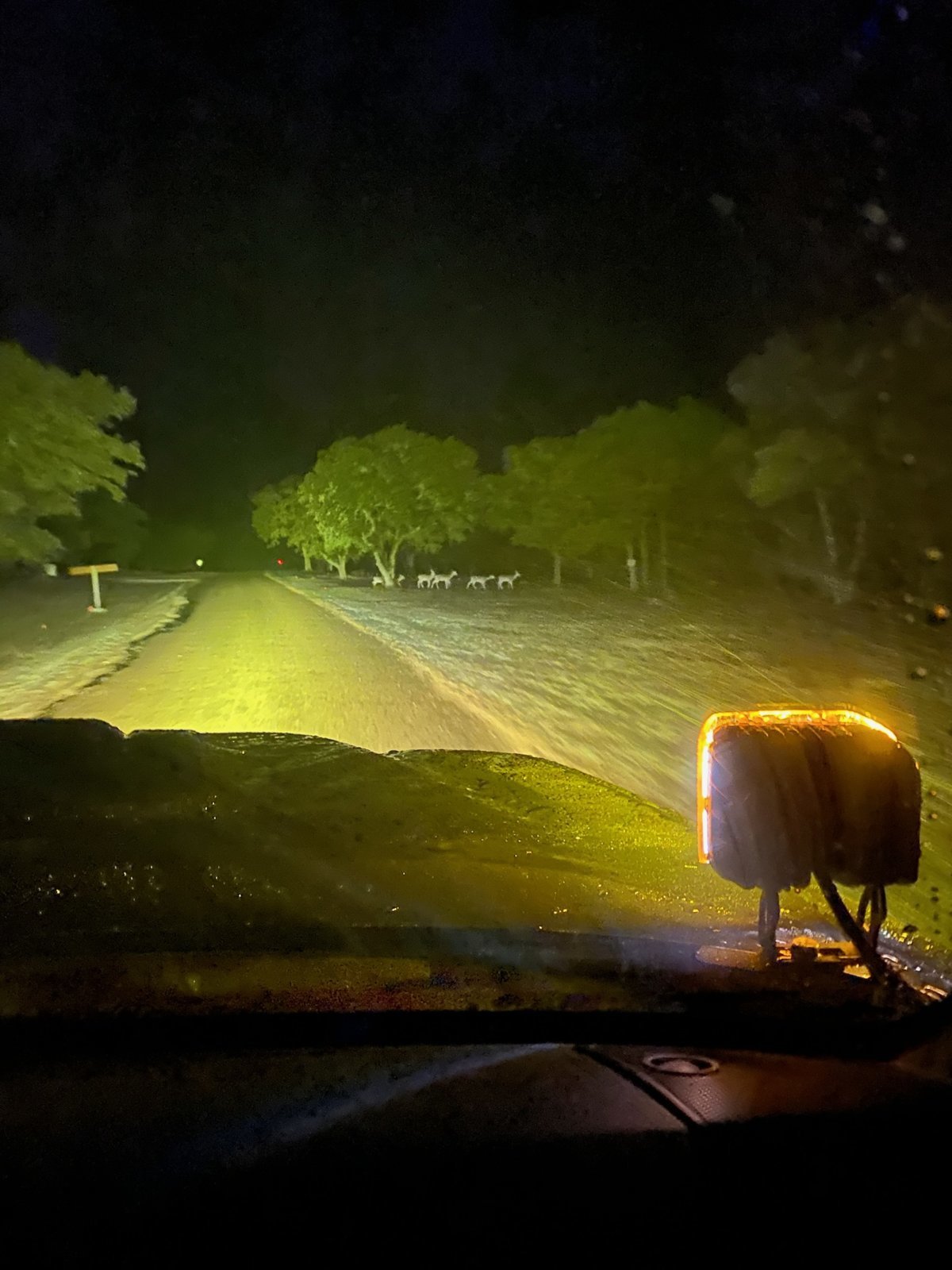

    How big a light can you safely mount on those? I got a pair of those big KC Day Lighters, but I'm worried they might be too heavy for the bracket and bounce around (or worse)....

    I assume if they can hold a LP6 they should be sturdy enough

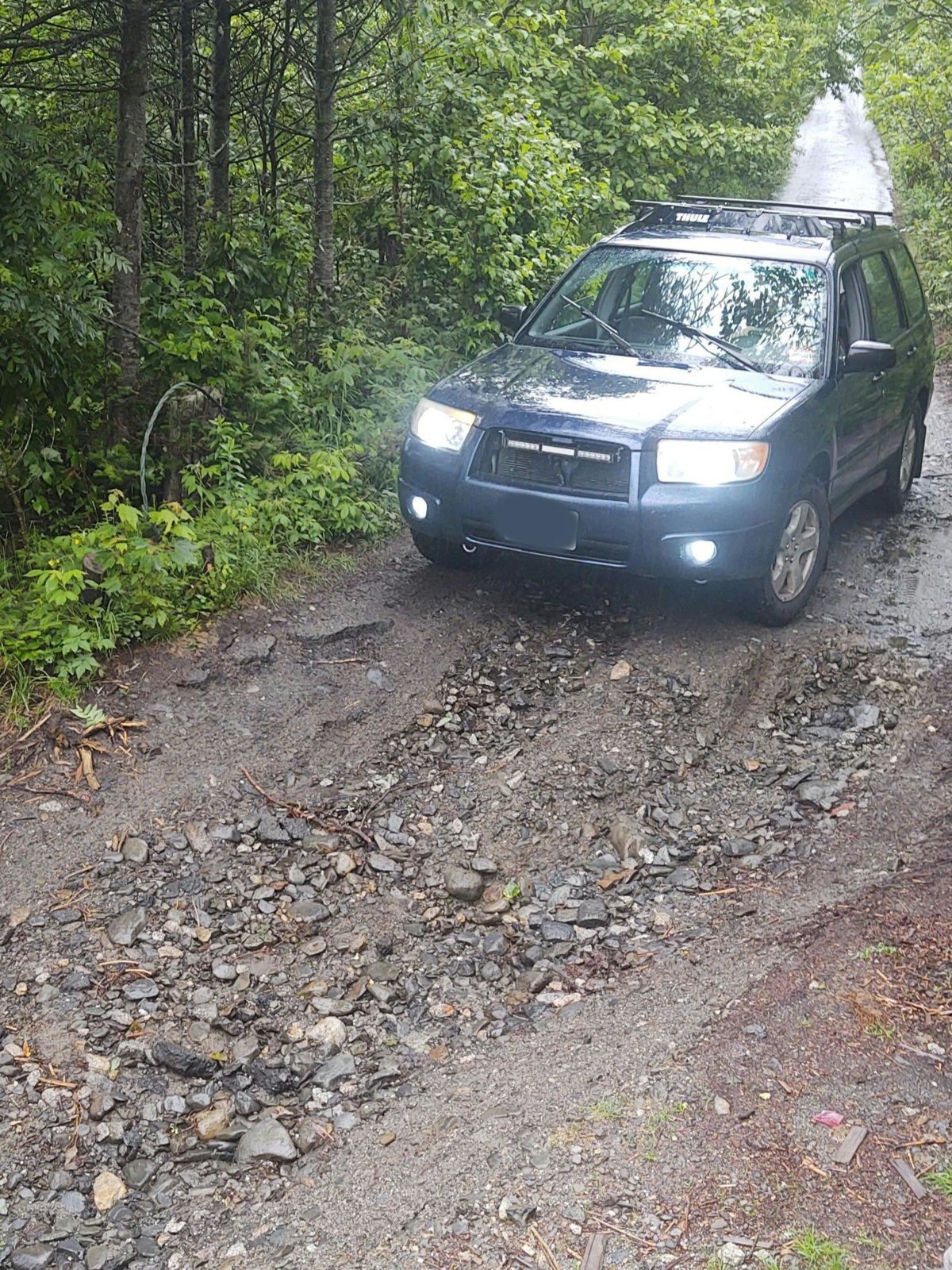

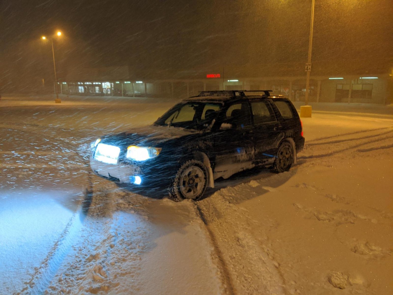

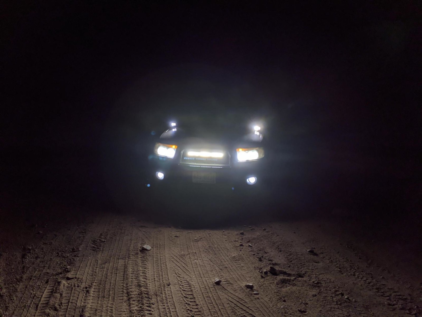

    On my 06 Forester I had an 18" @Diode Dynamics driving pattern light bar behind the grille, a pair of SSC2 Sports in the fog pattern as ditch lights, and a pair of SSC2 Sports in flood pattern in the rear bumper. I'd also swapped my low beams, high beams, and fogs for 6500K LEDs. The LEDs were the worst, I'm never doing that again. I loved the DD lights though, I got plenty of light down the road and a decent amount into the corners. At 85 mph, I was close to outrunning the lights I had, but I never did. In hindsight, I should have gone with SSC2 Pros for the ditch lights instead of Sports. The reverse lights were great, especially backing into parking spaces at night. Unfortunately I don't have any driver's POV pictures and the car is gone.
    MicrosoftTeams-image (23).jpg MicrosoftTeams-image (24).jpg MicrosoftTeams-image (25).jpg

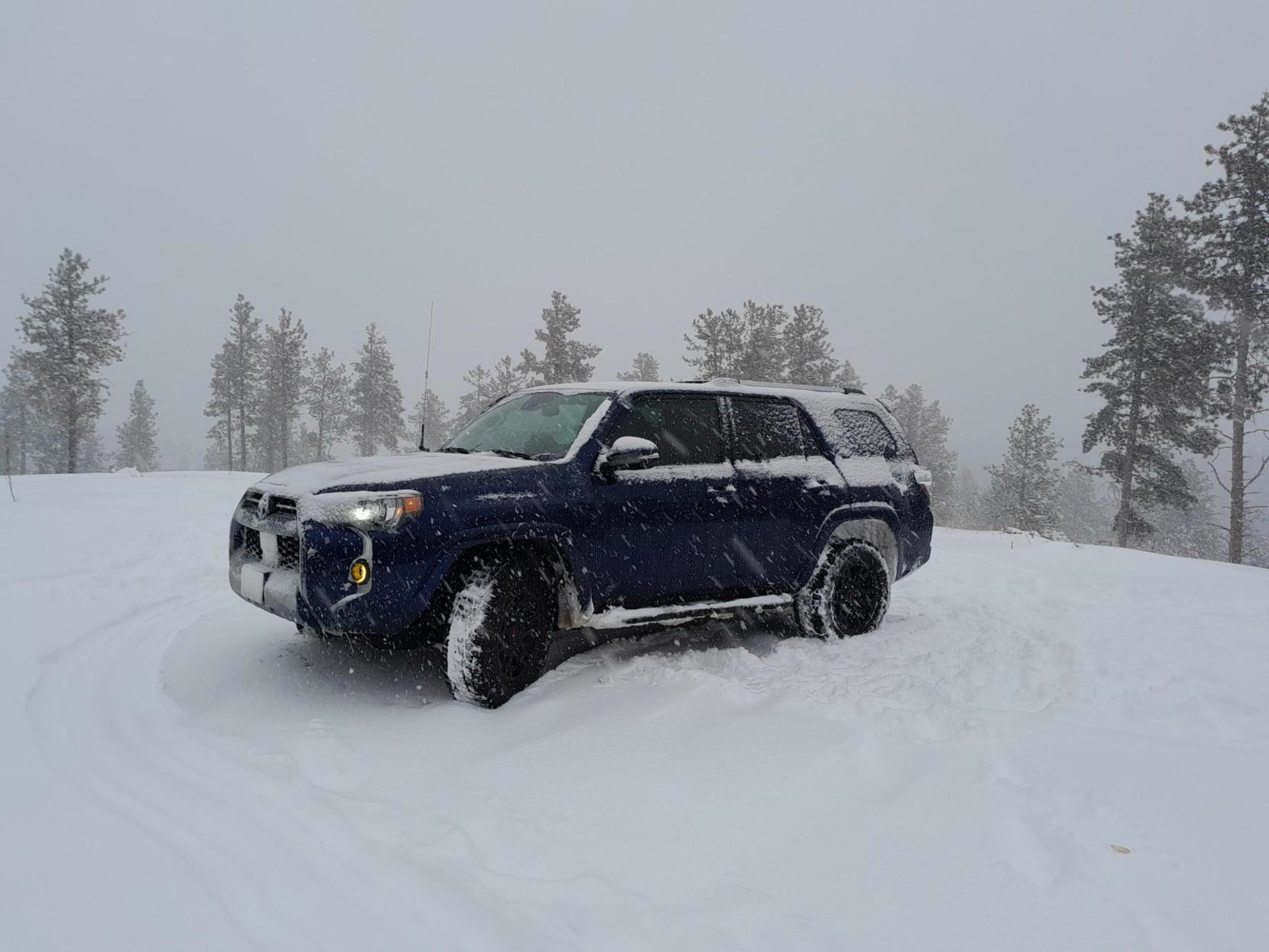

    On the 4Runner, everything is stock except for DD SS3 Pro selective yellow fogs and HIR bulbs in the reverse lights. They're both great, the fogs put a decent amount of light into the corners, although not as much as the ditch lights on the Forester. The HIRs are quite nice for reversing at night, but I wouldn't mind more. For a $12 upgrade though, they're well worth it. The stock high beams are anemic, especially compared to the light bar I had on the Forester, so I got a pair of KC halogen Daylighters, both the wife and I having learned that we prefer warmer, lower color temp lighting. I was planning on mounting them in front of the upper grille, but nobody makes a mount to do that easily, so I'm leaning towards mounting them at the A pillars. I'd like a set of proper ditch lights and reverse lights, but I'm starting with the Daylighters and seeing where those get me.

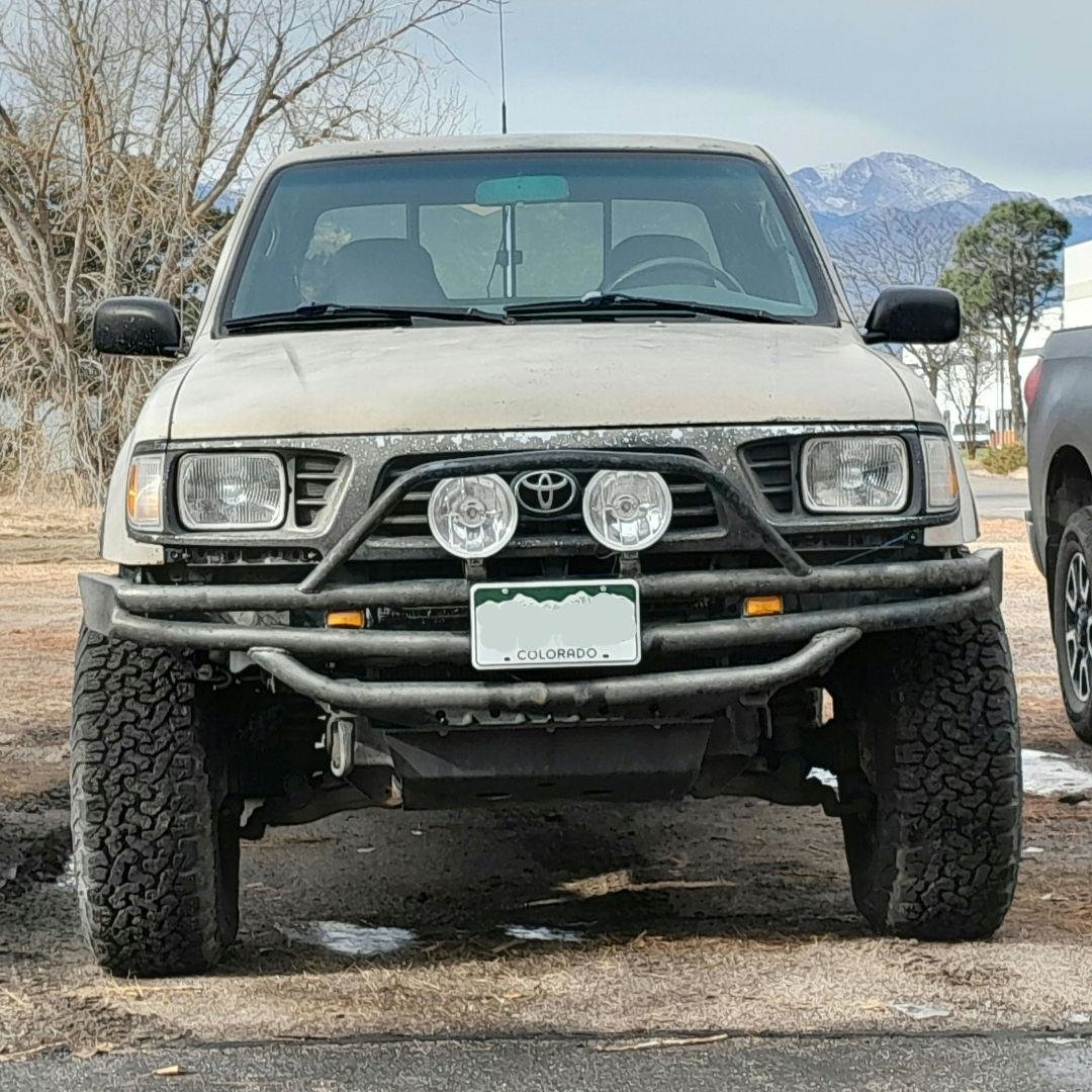

    On the Tacoma, I have swapped the original sealed beams for Hella E-Codes with Phillips Racing Vision +200 bulbs, which have made a huge difference. The previous owner added a pair of Hella 500FFs to the bumper, so I've been using them some, and they are nice, but I'll be swapping the bulbs for 100W bulbs and rewiring them with heavier gauge wire and tying them to my high beams so I can flip them on and off with a single switch. I'll also be adding fogs, probably 6" KC Apollo Pros, and replacing the cheapo blue LED reverse lights with PAR36 halogen reverse lights. In the future I'd like to get a pair of Humvee IR lights to mount to the bumper for driving under NODs.

    Which brackets are those? An LP6 is 4.2 lbs, a Daylighter is 7, but I'm willing to try.
    Do you have any vibration of the lights with them?

    sorry i just found the pictures on the internet, I was just merely saying I have seen people running LP6 (i assumed they were heavy) on their ditch light location. Good luck!

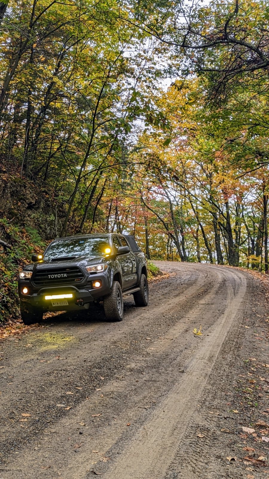

    They are very solid mounts. I have seen some big lp's on there a bigger concern to weight is can you still open the hood. I would not run anything over a small pod personally. I almost went with lp4's or XL80's but I didn't like the increased blind spot or the fact that they would hit the a pillar/windshield with the hood open.
    I ran rigid d series pods before these squadron pros and the squadrons sit a little bit lower and even that was a really nice reduction to the blind spot.

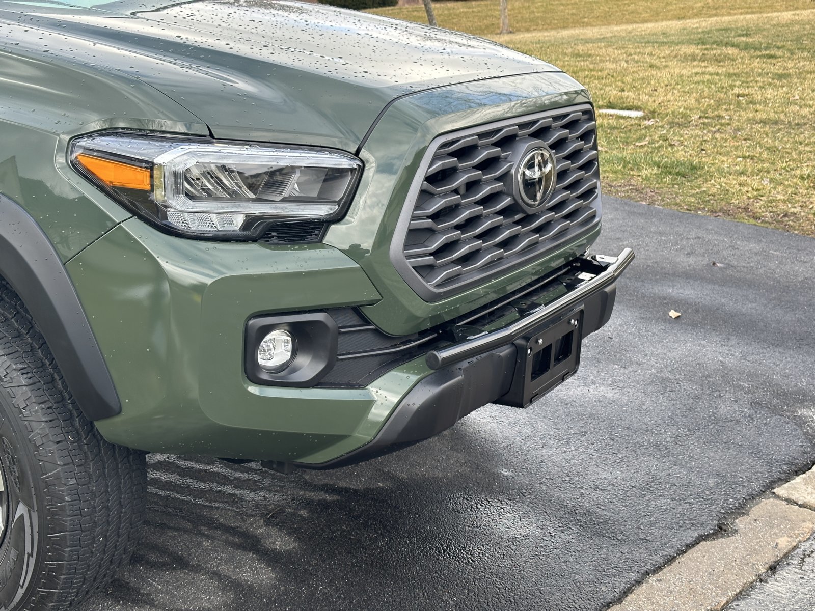

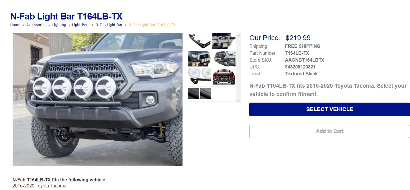

    Where did you find that? Everywhere I look I get 'out of stock' - and I can't find it on the n-fab site (which now ends up at realtruck.com, which makes me think they are out of business)....

    I found it on autoparts dot com I think that’s what it’s called, I have ordered it and not received it yet. Fingers crossed. Yea I think nFab doesn’t make a good business because how poor their instructions or lack there of.

    got it installed. Very solid product despite nFab not in business anymore.
