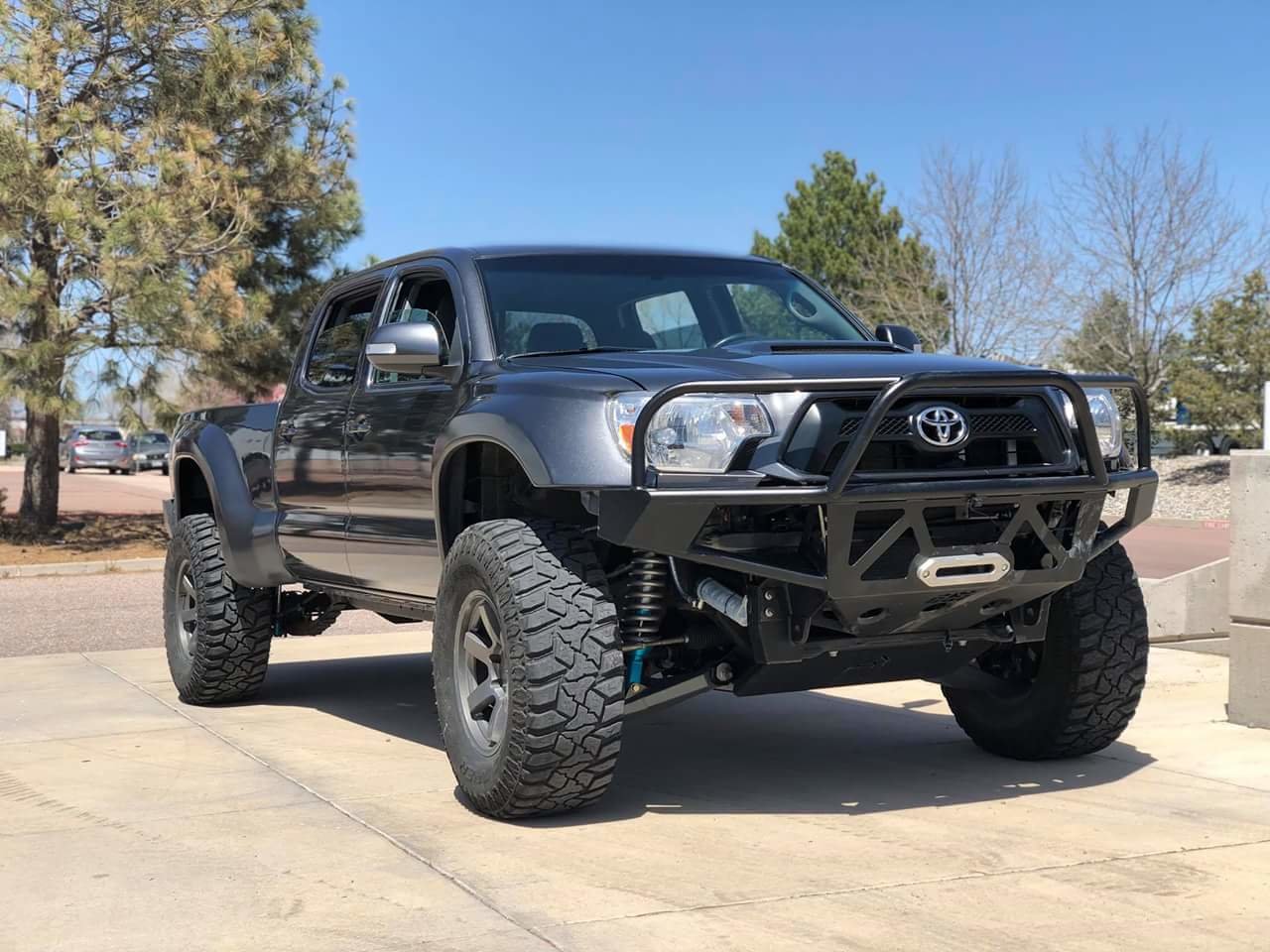

    I just put Camburg's kit on my new truck (15 DCLB 4x4), went with the adjustable uppers, just the adjustable C/O. In the rear is from my last truck: Deaver SUA (U539/U540), Archive Garage's shock mounts and shackle hangers,2.5 RR 14".
    Hasn't even been on dirt yet, but it rides nice on the street.
    I went Camburg because everything was in stock and easy to get. If I had the time to wait for shocks to be built (King is about 6weeks) then I would of gone either Solo's 3.5" or TC's race kit. What ever you do definitely get adjustable uppers.
    Pic because I just got it back from paint last Friday:

    That's looks sexy! So Camburg had the LT Kings in stock??

    Thanks! Yeah they had a couple sets in stock at the time (February).

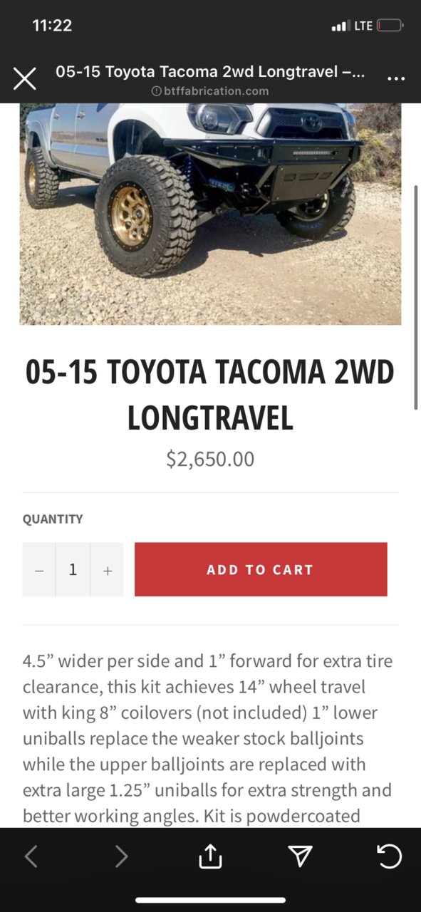

    I need some advice and help I’m in between total chaos LT or dirt king what would you go with and why 08 Toyota Tacoma 2w drive
