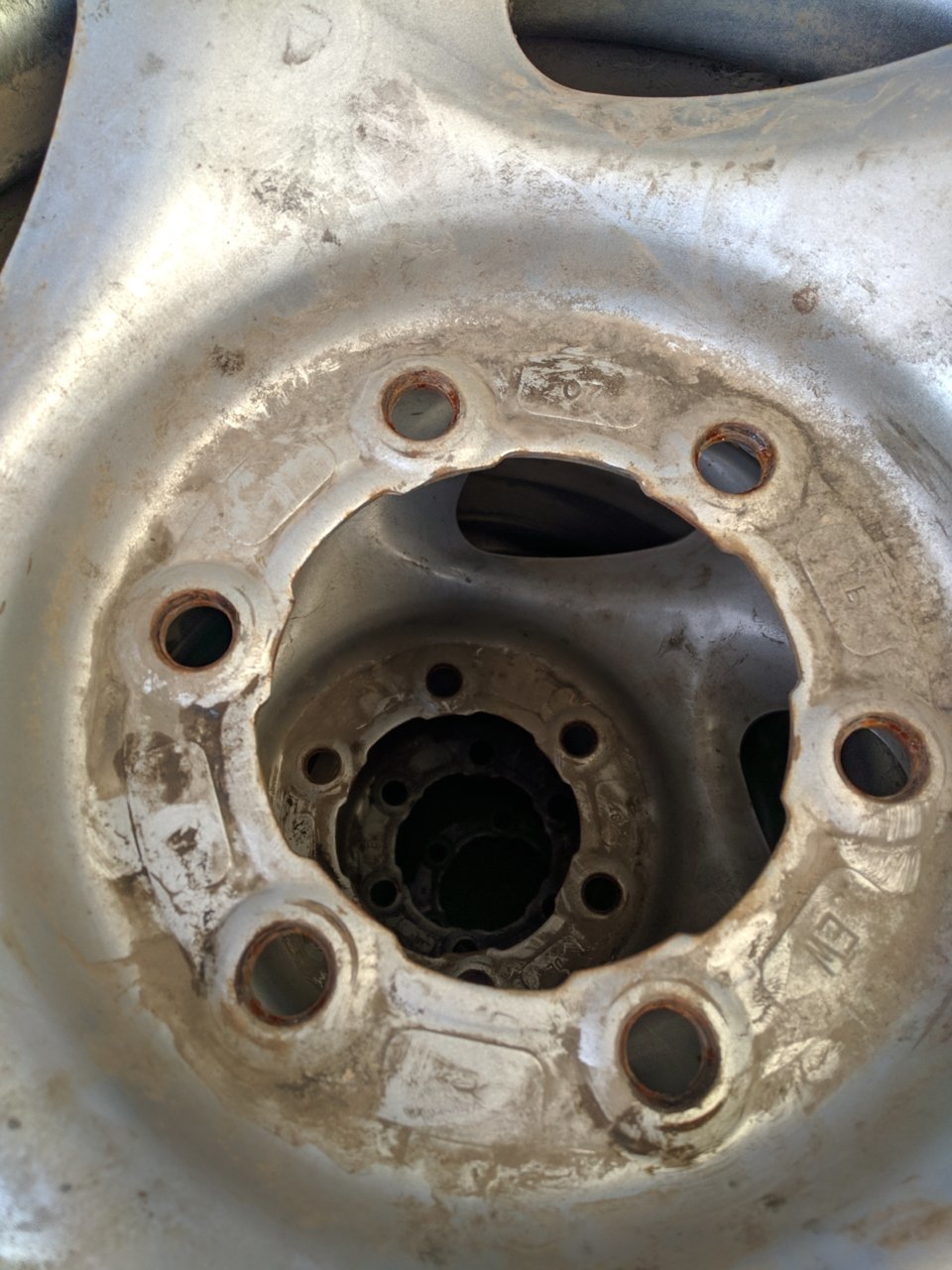

    I just bought a set of Oem steel wheels off a 2002 Toyota Tundra with snow tires on them to put on my 2000 Tacoma. Tried putting them on but my stock alloy wheel style lug nuts won't work.
    What style lugs nuts do I need for these wheels? The holes in the wheels are tapered in slightly.
    These are the wheels:

    Technically you oem lugs will work. Your oem spare is steel and the oem lugs have the proper taper on the end. For some reason there is alot of misinformation on this out there. I think its because Toyota is the only one that did that.
    If you want something a little more stylish and acorn or acorn bulge with a 60° taper in 12x1.5 will work, open or closed. Something like this. Just make sure if you go closed the are long enough your stud does not bottom out.

    So the oem style that I have on my alloy wheels will work? The taper seemed the same but there was a gap between the washer on the lug and the surface of the steel wheel, so I wasn't sure if they'd tighten down all the way.

    Some of those bolt holes look oblong... could lead to a wheel off

    Your oem lugs look like this?
    Yes, I'm not saying it's the best lug to use. But a 60° seat is a 60° seat.
    Now to the condition of the wheels you bought idk?
    Maybe it's best for you to take everything to a local tire store and have them check things out.

    Yup, they look like this. Wheels are in good condition, trying to save a little money by not going to a tire shop, but might have to.

    Literally any 60 degree seat style lugnut. I wouldn't personally recommend using your stock lugs on used steel wheels because the area of engagement is relatively small, they have that seat to be used on the spare wheel, which has almost no miles out on it and therefore almost no wear on the lug seats, unlike wheels that are run every day.
    12x1.5 thread pitch open ended 19 or 21MM Lugnuts will be cheapest. Don't pay more than about 1$ each (25-30 total)
