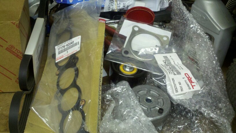

  20. Apr 9, 2013 at 10:34 AM
    #40
    SDSam
    SDSam from Dirt bike to Dezert Couch
    Jun 7, 2012
    #80249
    690
    San Diego
    00 Tacoma prerunner
    Icon Shocks, BTF front, Deaver f67, 33's on stocks, Fiberwerxs 1pc, TDR S/C, Bed & Eng Caged
    All the toyota parts are came in:
    bought it from this place. http://www.toyotapartszone.com/
    ItemDescriptionShipped
    PTR30-350403.4 SC DRIVE BELT 1ea 11.00
    PTR26-35042CHECK VALVE KAYNOR 1ea 6.11
    PTR29-60030GASKET, THROTTLE BODY
    17176-62040GASKET, AIR SURGE TA 1ea 8.54
    11213-62020GASKET, CYLINDER HEA 1ea 18.56
    PTR30-35041TENSIONERWPUL 3.4SC 1ea 50.10
    The tensioner is only that not the full kit which i will have to make myself.
