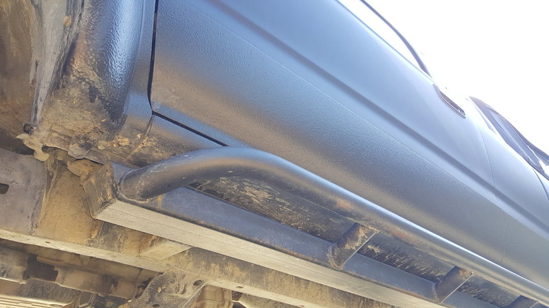

    I got mine welded...best choice i made...its stronger bro ..trust me

    Hybrid with the 2x4 beam its the strongest

    Incorrect. Bolt ons are just as if not stronger.

    @ baby ruth...i seen boltons damaged at trails ..ur not going to convince me..go to any fab shop they will tell u the same thing

    believe the bracket may be a big part. the DO ones use a U bracket that wraps both sides of the frame. I jacked up my truck with it with no movement. Havent had it banged on a rock yet so I could be wrong, but I feel pretty confident with them.

    Rock crawling wouldnt be recommended. ..it just depends the trail and how u drive ur truck

    Then they were dumpy sliders. I had BAMF bolt ons on my taco, and have AP bolt ons on my FJ. They are just as good as weld on period. The bolt on taco sliders wrap around the frame, where weld on are only attaced to the outside face and bottom of the frame. If anything the weld on sliders would rip out of the frame face before the bolt ons failed. Any decent fab shop will tell you either option is more than adequate.
    If you have seen bolt on sliders get damaged they were either junk or installed improperly.

    I agree ..it just depends who makes it..some r good sum r shit!!
