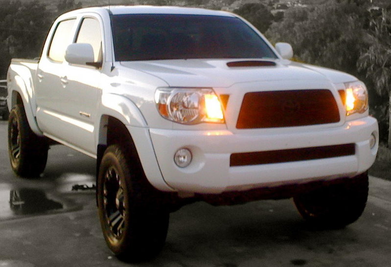

    hey so i just put a 3 inch leveling kit on the front of my taco, and slapped on some 33 inch tires with some monster XD rims (flat black) taco looks beautiful! i use to get around 350 miles to the tank, and now on a good day when i have to fill up i get 280, im wondering if i re gear my truck how much gas mileage ill gain, and if its a good idea? im really just looking to get my mileage back, and to re gear before thinking about cold air intakes and exhaust kits to boost the mpg a bit more! also does anyone know what re gearing runs around? and the best combo with cold air intake and exhaust? i aint no wizard at this stuff but i know the basics of it all, please fill me in! thanks!

    hmm well ill try that, i just been looking at what i have every time i fill up which seems more often. also had good feeling i was getting less on the fact that my brother has the same truck as me and we went on a road trip with the family with both trucks and i had to stop more often then him. traveling same speed and all.
    oh and heres a pic!

    Looks good dude.
    Honestly, besides keeping your tires properly inflated, timely oil changes, and not having a lead foot, I don't think there is much you can do for MPG.
