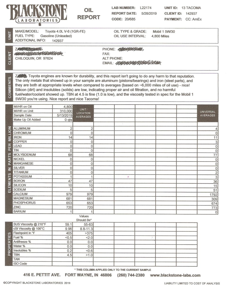

    you could have gotten the same results changing your oil every 10k

    You are averaging 45K miles a year. Clearly, these are highway miles, the least taxing on an engine and transmission unless you drive at very high speeds. The TBN value of 4.5 is very high; this, combined with highway mileage indicates you can safely change your oil at 10K intervals. You'll only be saving more $$; well, it's not bad for the environment also.
