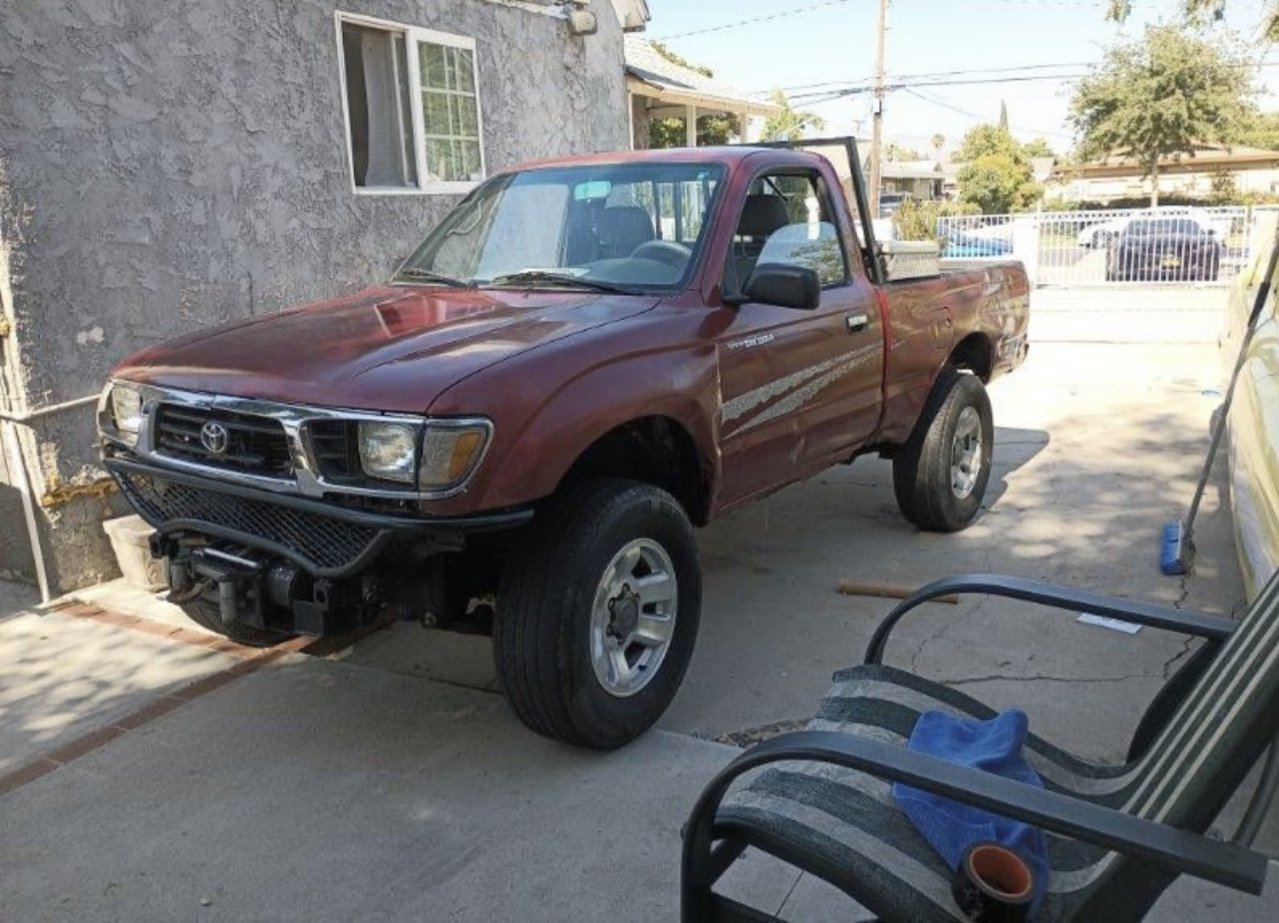

    thanks. The truck decent body wise it has dents here and there nothing big but engine running strong. Bought it a week ago for 4,500$ and what my luck this happens when I’m on vacation. I just bought the parts to fix and I have a family mechanic that doesn’t charge me a lot so I’m kinda lucky there. upload_2023-7-29_11-33-50.jpg

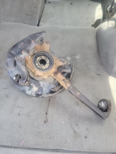

    Hi does anyone know where I could order this part online … mechanic cant find it locally…. Or the name so I could look it up on eBay.

    There are a bunch of parts there. Spindle, bushings, brakes, bearing.... what is he specifically asking for.? Or is looking for the whole assembly?
    BTW, wtf did you hit? A curb, sending it off road. Normally that entire arm doesn't go bad all at once.

    You would need to press out the axle hub, and once you do that, you won't want to re-use the bearings.
    So really it's best to just find a use spindle (that large part) with axle hub, bearings, etc already in place and move over your brake dust shield.
    You'll want one from a vehicle with 4x4 ADD so either 1995.5 - 2004 Tacoma or 1996 - 2002 4Runner.

    I wasn’t driving it when it happen. It was my mom …. She was going full send over a speed bump and just heard a loud noise kept flooring the gas which made it worse. When she saw that the truck wasn’t going that’s when she got out to check what happen ‍♂️ …. His looking for the full assembly …. Mmm should I get it new one or just rebuild the hole spindle ? I’m new to all this so don’t have much knowledge

    Likely the spindle is ok, just get. The bearing, ball joint and all related bushings. That's what is needed. Others have more experience with this than me and I an sure they will chime in.

    It's not, he needs a spindle.
    It's bent up top where the upper ball joint goes.
