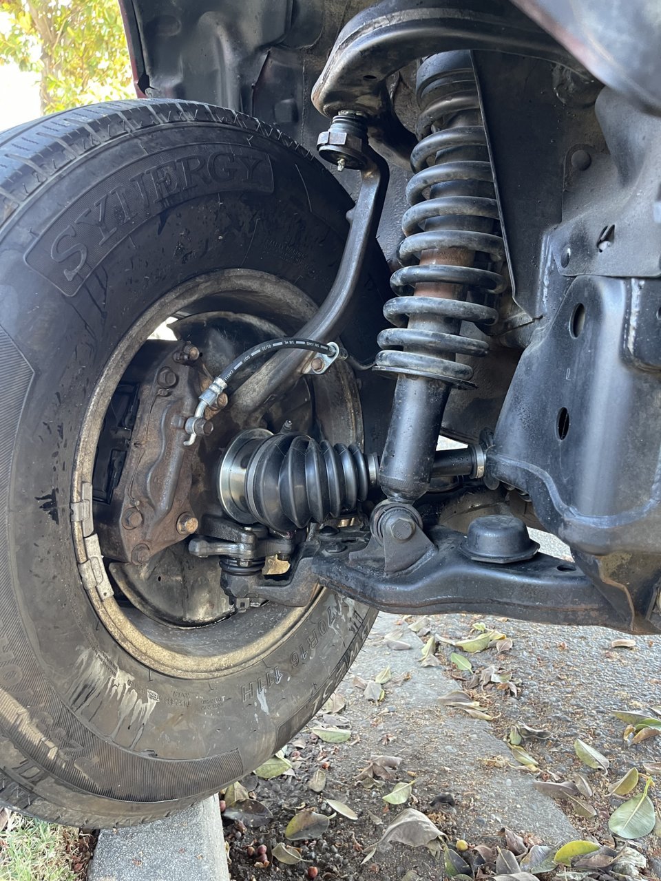

    4 run, 2 don't
    What sucks is, the fix is really quick and easy but it seems the OP isn't mechanically inclined (not to mention not at the vehicle).

    Got it thanks for the reply …. So I could rebuild the hole spindle if I wanted to but will be more work ? Might just go with the 2nd option of finding a good used one

    Sorry for the confusion, no you can't because it is bent.
    The only part you can really salvage from the old spindle is the dust shield and axle hub.
    The best thing to do would be to buy an entire spindle with associated parts already in place.

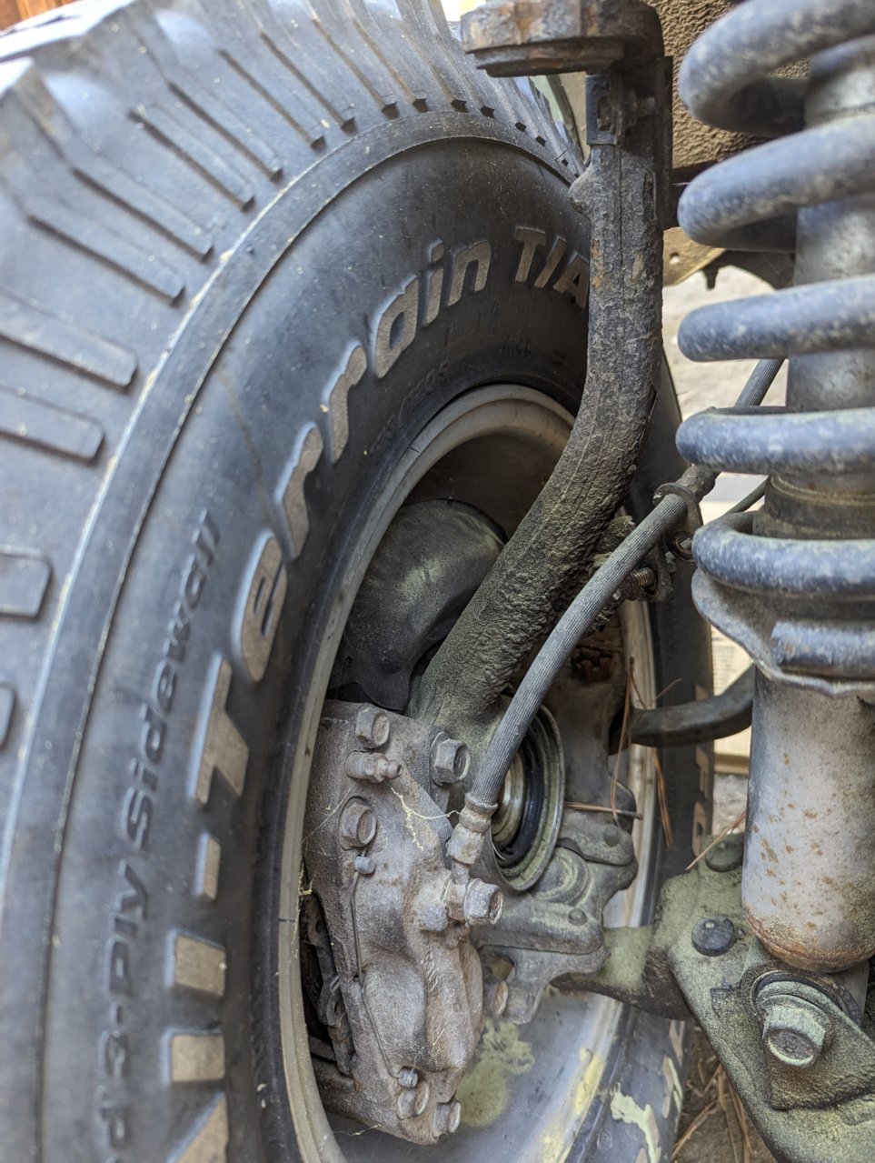

    As vette said the spindle is bent, you need the entire assembly posted in your pic. Spindle, upper and lower ball joint, plus all associated bushings and seals.

    @Carloss1017 I have what you need. It is off a 2000 Tacoma TRD with ADD hubs and abs. If you don't have abs on your truck you can just cap the hole over the tone ring.
