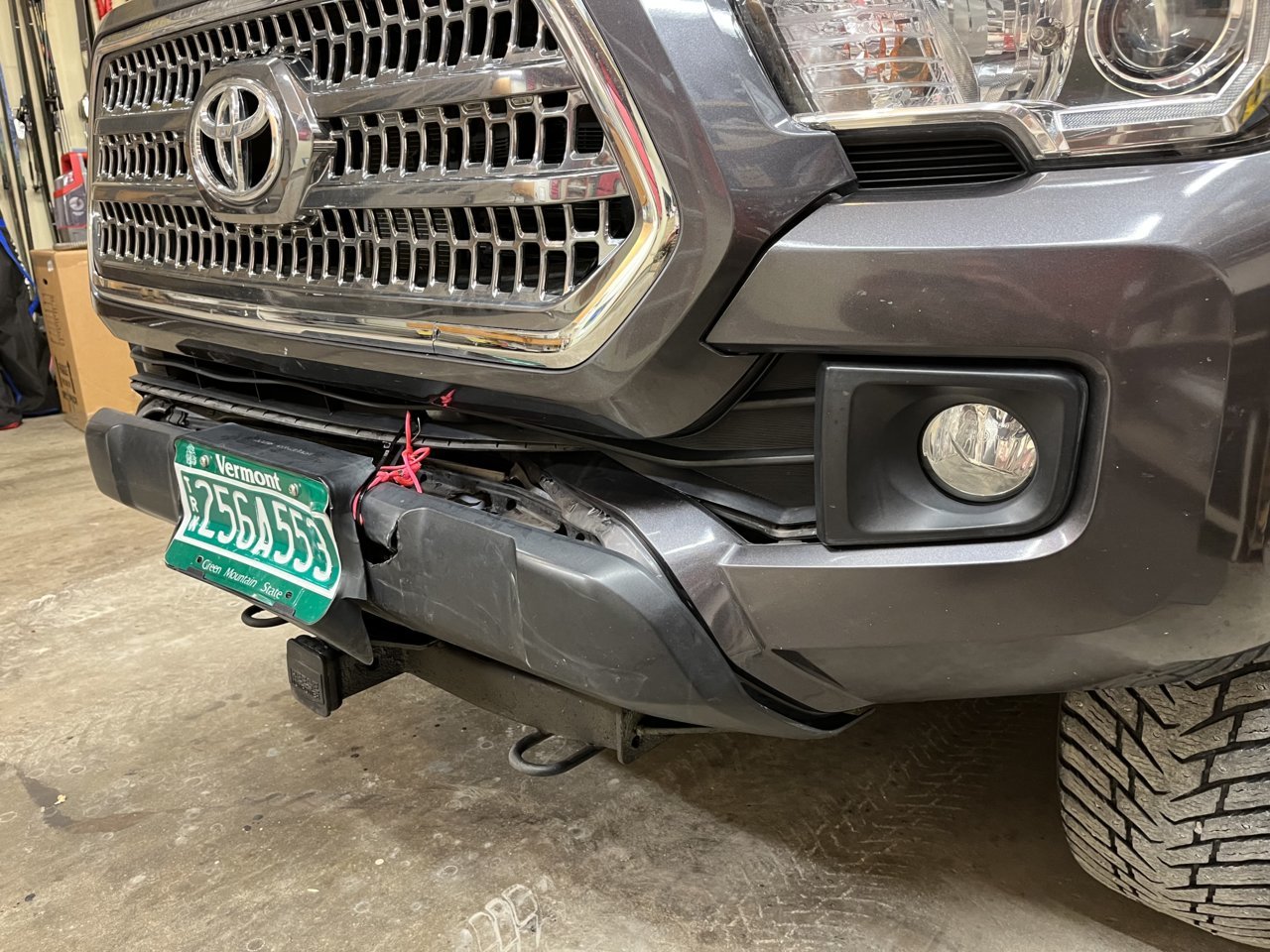

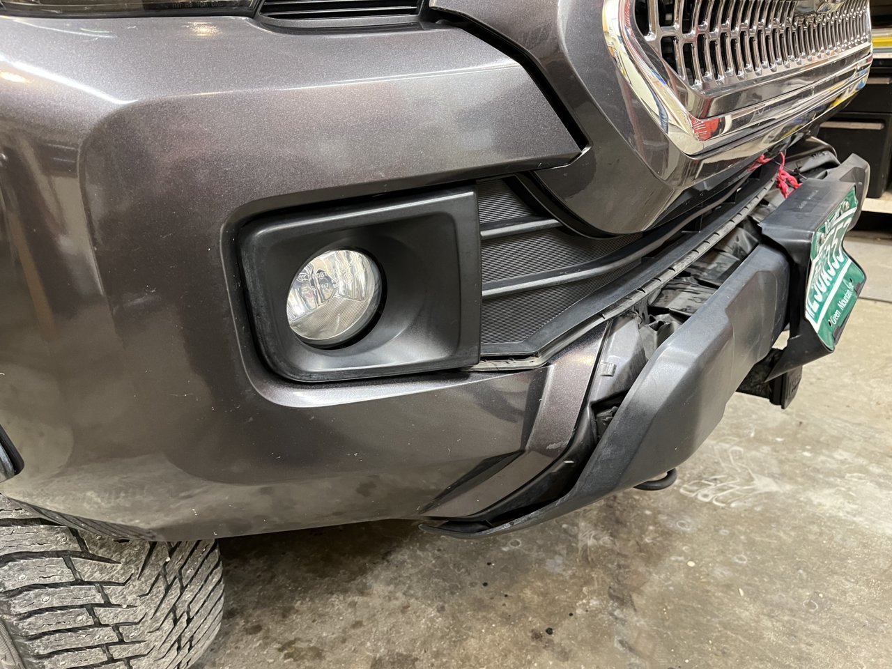

    This was about $3,000 in damage. I did the repairs myself since all of the damaged parts were bolt on (no body damage). I bought a new bumper skin (about $200) but was able to reuse my old one by heating it with a heat gun to take the kinks out. There is a tiny mark on the bumper above the license plate but otherwise it looks like new. The new skins are unpainted black plastic so that's why I reused the old one.
