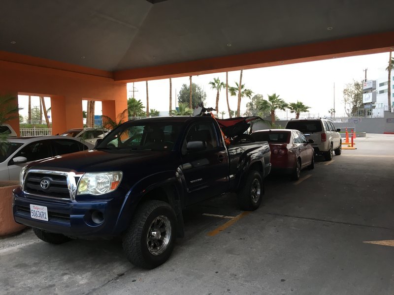

    IMG_9618.jpg Thanks everyone. Saved me from big headaches.
    People should be careful buying any salvage vehicle. Make sure that the inspection already took place and the vehicle and the vehicle was issued the new title and full (not temp.) registration. I actually found several more trucks like this one while shopping around. They buy at action, duct tape over huge issues, and look for a sucker.
    I'm super happy with my new 08 Tacoma.
