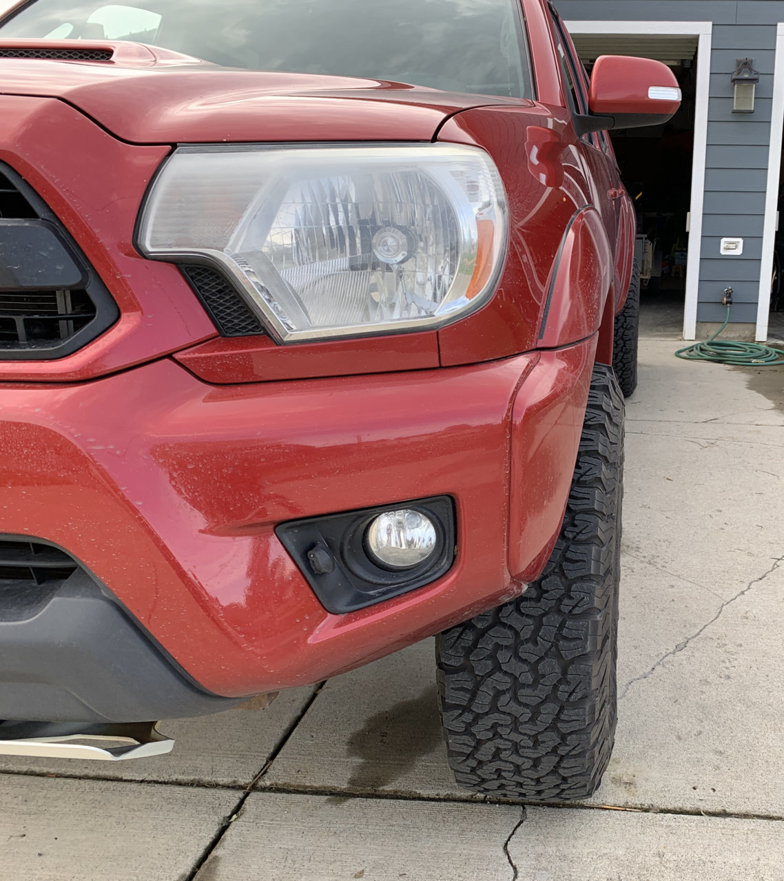

    Thats what Im looking for, nothing crazy. Could you send a picture?

    these are with 285s, 265s are only a 1/2 inch less for poke.

    Damn that looks awesome, exactly what I want. So if I wanted that look I could go for a -12 and it would look pretty similar (I know 2mm is a fraction of an inch but it would be a little closer to what you have)
