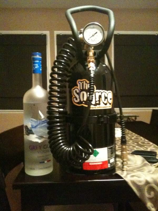

    I just received this killer CO2 setup that I won on ebay for $202. The system was brand new and it came with everything (retails for$460)
    This is what they call the 10lb tank and that goose bottle is the 1.75 liter bottle for comparison photo-1_15b7ecb34b60bc77cc618d54e05992f9fce120c1.jpg

    How well/fast does it fill your tires after being aired down? Can you run an impact off this setup?

    This compressor would be perfect for "just in case". The thing it won't do is run air tools or fill all 4 tires to 30 psi from say 10 psi in a very timely manner. I could not find the duty cycle in the details but the compressors with higher duty cycle cost closer to $150+.
    http://www.trdparts4u.com/Scripts/prodList.asp?brand=arb&curPage=2&sortField=sku
    Look towards the bottom of this link for compressors that handle heavier duties.
