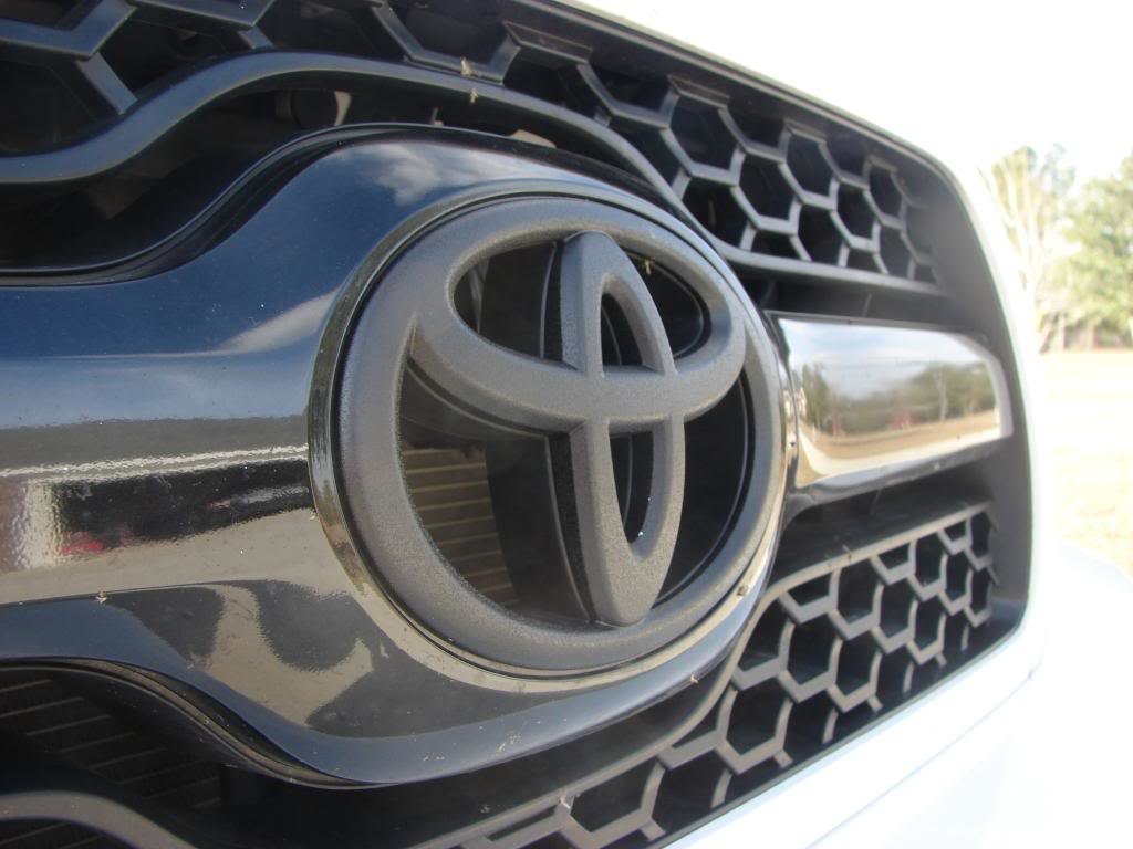

    i wanna paint my front grill emblem flat black, what kind of flat black paint should i use? also should i use a primer before too? ive done got it sanded down now ready to paint

    plasti dip. thats what i did mine with. here is a pic on the truck i did it back in may and it looks just as good as today as the day i did it. [​IMG]

    Krylon fusion satin black. It adheres to plastic. I'd even put some adhesion promotor on it before.

    I just scuffed mine and sprayed it with Rustoleum brand truck bed liner.

    Plastidipped last year and it still looks like it did that day.
