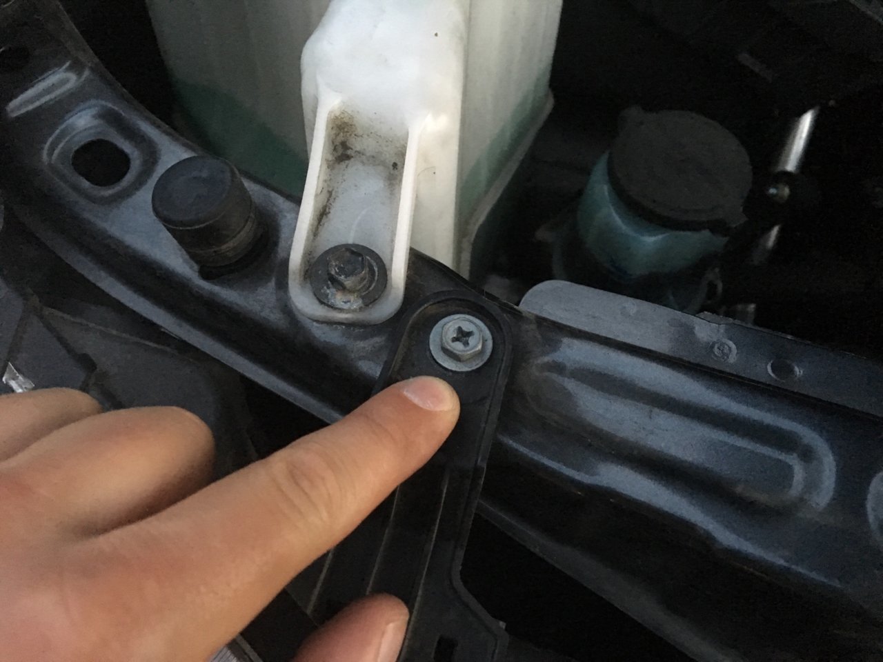

What part number is this? Need to order one

    located under the hood behind the passenger light. It is the white thing the screw goes into. Stripped from the factory and I want to replace

    You're not pointing at the white thing in the picture. And the white thing in the picture doesn't have threads to strip.
    So can you clarify ?

    I am aware, but didn’t have it apart at the time. With the screw is bores out threads/friction fit. They managed to bore it out completely by over torquing it. Drivers side is tight

    It's essentially a nylon nutsert or crush nut. You should be able to buy a generic pack of them from any auto parts store.

    90189-05142
