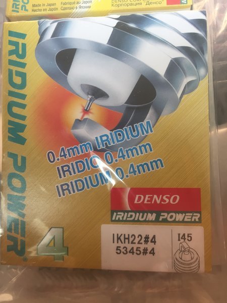

    Coming up on my 30k plug change. Just wondering what other people with the blower are running.

    Should be running iridiums, IK22. Are you currently running copper plugs? I don't know about 2nd gens but on my 1st gen, the stock copper plugs make the motor ping like crazy with the supercharger. Forced induction likes colder spark plugs

    I'm not sure what the exact part number is for 2nd gen v6 Tacomas since I have a '04, but those are the right kind of plugs. I'd just verify with them or Toyota that those are the right part # and you should be good to go.
    Might want to verify with the dealership that did you supercharger install and see if they installed new plugs when they did your supercharger. I know that the Magnunson version (same supercharger without the TRD logo) is sold with new spark plugs as part of the kit. It's possible that they may have put the right kind of plugs on when they did your install, and if they did then your's should be good for another 60k miles or so since the iridiums are good for up to 100k

    Indeed they did swap them out.
    Good to know.

    These came in the supercharger kit I just bought.

    Once you are swapped to the iridiums you should be good till 100k on them.
