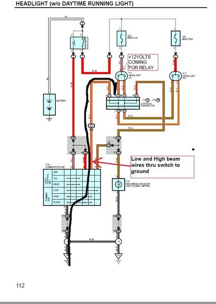

    1st gens are ground controlled. The head lights are controlled by grounding thru the switch. You will have one wire positive and the other 2 one be an open ground until high beam is selected the other one, will be grounded when low beam is selected. Completely different then a standard setup.
