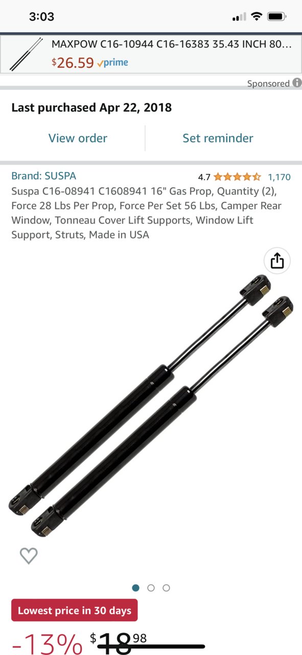

    MAG GRY TACO15
    MAG GRY TACO15 Well-Known Member
    Sep 5, 2018
    #265273
    5,065
    Alan
    GA
    '15 TRD Off-Road
    Same crap everyone else got
    These are what I ordered back in 2018 and they are still going strong. I opted for the stronger ones over the replacement force ones b/c they always seem to wear quickly with the weaker shock and the window doesn't seem to want to open all the way up.
    Leer 100xr also.
    https://www.amazon.com/gp/product/B00774U6HY?ie=UTF8
